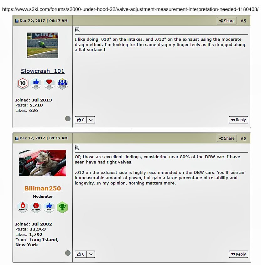

1. On this car the valves must be adjusted when the engine is COLD. Under 100°F (38°C). Just bringing the car into the garage will exceed that temperature.
2. Set the valves to their MAX tolerance: Intake 0.010" and exhaust "one thousandth over" to 0.012". This has been strongly advised for 2006+ cars for almost 20 years especially since the valves tighten in use.
General rule is if you can't hear the valves clicking they're too tight.

I think you need to go through each step again and set the exhaust to the .012 as specified above. Also when you are doing the drag test with the feeler gauge it really needs to be just when you barely start noticing the drag. If it becomes tight at all you are compressing the enough to change the measurement. Also make sure to verify after you have tightened the nut that you it didn't change the measurement. Even then I still don't know how it would give you a rough idle unless somehow the measurements were WAY off.

Yes, the drive-by-wire AP2 engine's exhaust valves require more clearance than those of earlier AP1 engines.
