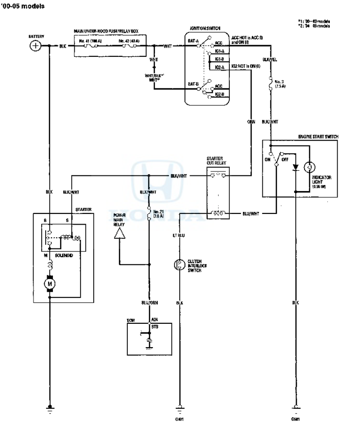

Clutch interlock switch is a common problem, check that first.
Here is circuit diagram for more help.

Thank you for your reply Flanders. Sorry I should've mentioned that I've tried bypassing the clutch interlock switch. The car behaves the same with and without the clutch interlock switch.

Check the starter cut relay.
I previously posted some instructions about it here and in the following posts
https://www.s2ki.com/forums/s2000-un.../#post24628377
Thank you everyone for the helpful replies. I’m going to ohm out the starter cut relay and check the wire going from the ignition button to the board tomorrow before I go to work. I am sure it is the relay and not a break in the wire but anything is possible. I checked the voltage on the starter after I installed it, it gets 12V.
