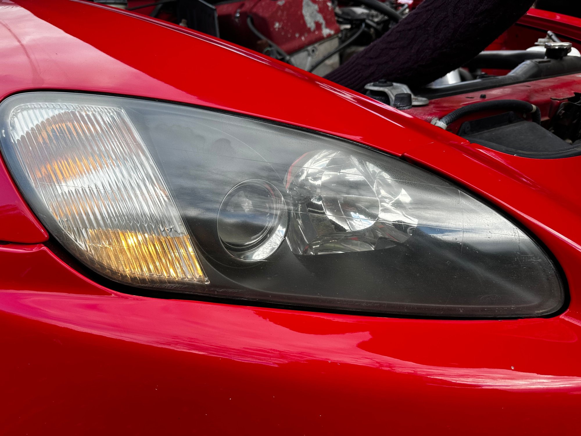

the thing I’d like some advice on is my headlights are terrible I can only see about 2-3 meters in front of the car, the lenses seems pretty clear so I was wondering what I do To greatly improve visibility whilst driving in the dark

You think it's the lenses or bulbs? Photo will help us on the lens part. Be careful checking the bulbs as they're HID and high voltage. I've seen replacement recommendations as short as 3 or 4 years for these bulbs. I have a spare set in my parts box but my 17 year old HID bulbs seem fine. High beams are Halogens and bright versions are auto parts store items.

after checking the light, the bulbs are fine but think I’ve got some faulty wiring into them as when I wiggle it about they come on so think some of the connecters might need replacing!

Headlight lenses look fine to me.
You can clean/treat electrical connectors with something like DeoxIT D100L.

After cleaning, I would also recommend this -
HONDA (invisiblemask.com)
The thick, clear headlight film actually fills light scratches and dings, provides additional UV protection, and offers some scratch and chip resistance. Follow the directions and it's easy to apply.
