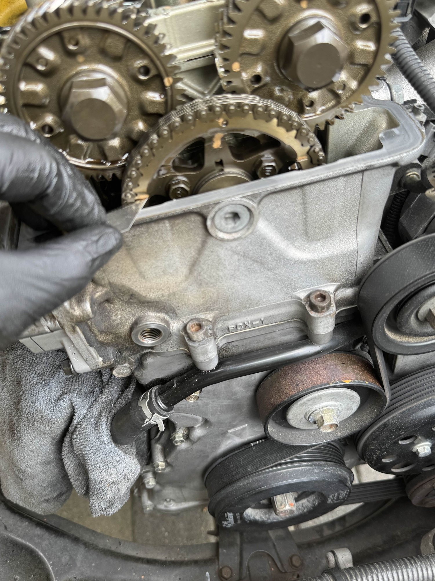

Would this be considered out of spec for timing, though?

Originally Posted by windhund116
Do you have an idea how the engine got off one tooth?
Thanks!
I did spin the car during an autocross -- I posted an image of the timing in the post above, maybe you can be my second opinion to determine if that's enough to be considered "off timing".

It might help to show all the timing marks.

This is the only image i took with the cam gears showing, whoops. I put the valve cover back on for now because it was getting late
From that angle, it looks okay. Maybe, try for a straight-on look when you get a chance.

Off a tooth is not something you have to wonder at. It'd be way off.
A little chain 'stretch' if what you're dealing with when it seems slightly off.
Obviously, metal of the chain isn't actually stretching, its just incremental minute wear at each link that adds up to something measurable in overall chain length. So it appears to have stretched, like a belt would.
A small amount of stretch isn't something to freak out about. Not like you must replace chain.
