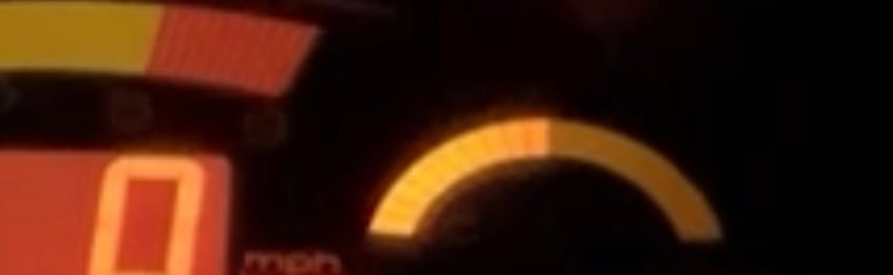

My ap2 s2000 is currently sitting in the garage for the winter, usually start it up at least once a week. Noticed that the car is running a little higher than half temp wise. Haven't pushed the car at all, just a few revs up to 4k while in the garage. The garage door is open, hood popped as well. Just want to know if this is something I should be concerned about or if it should be fine. Sits around 10 to 11 ticks on the gauge which is either exactly at half or one over half.

Its running hotter than normal
check your coolant level and check that your fans are working.

Are the fans cycling? Any differences with the hood closed? I can't recall any 10 or 11 segment reading on my 2006. 8 or 9 bars (counting the permanent bar at the bottom of the scale) appears to be the generally acknowledged normal temperature.
