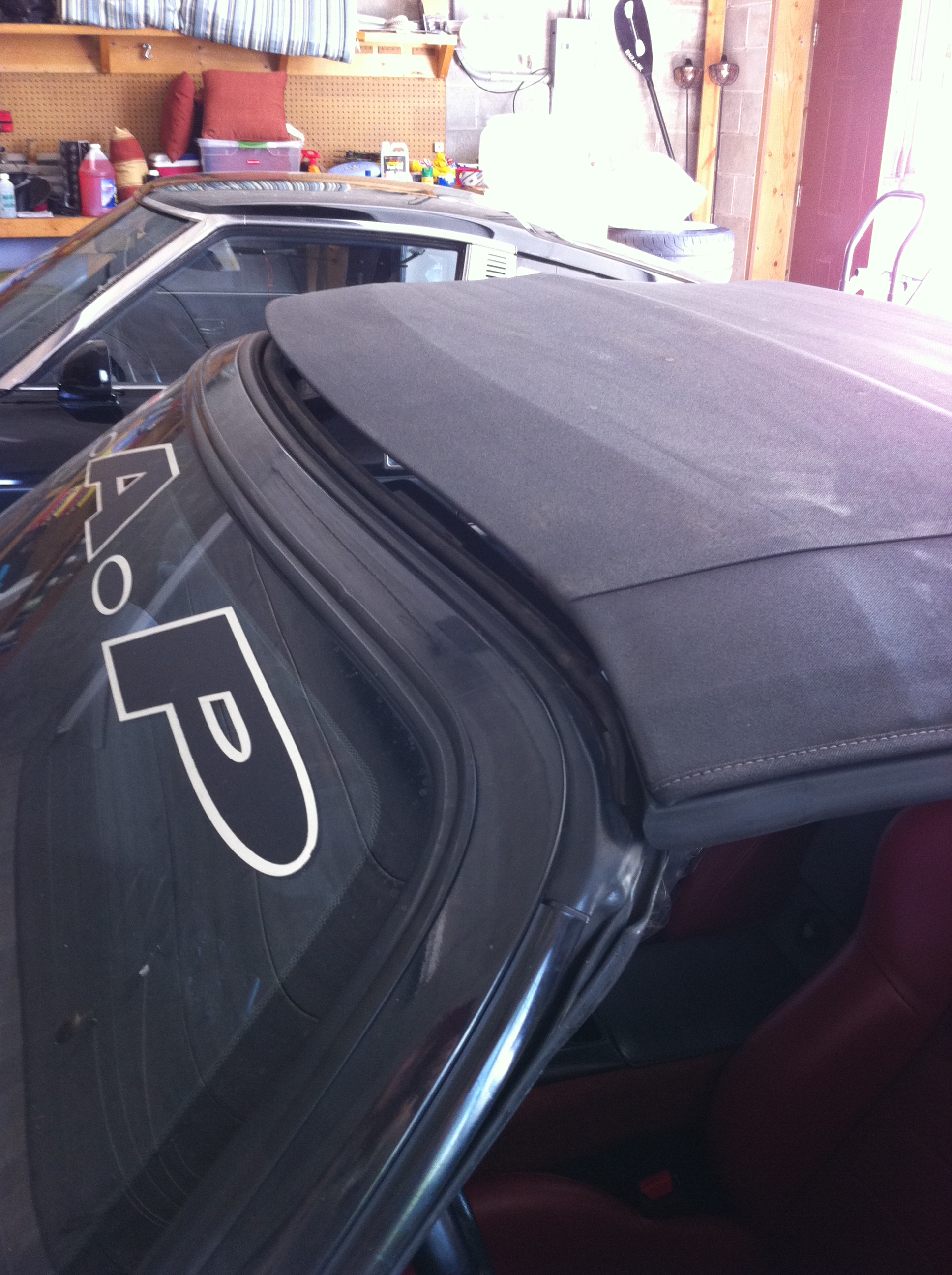

Hey guys so the previous owner had a hardtop on the car for a LONG time, I sold it as I pretty much only drive top down but now I found a couple issues with the soft top.
First and foremost it doesn't close!!! The motor doesn't seem to be an issue as it gets it to "almost" closed with no issues and in just a few seconds, but it stops short. I did forget to take pics of the outside of the top so I will take those when possible.
Anyway here are the pics of how "close" it is:
[attachment=2968:IMG_0285.JPG]
[attachment=2969:IMG_0287.JPG]
[attachment=2970:IMG_0288.JPG]
Any ideas what might be wrong? Also, I noticed the passenger side latch or locking mechanism (whatever you want to call it the thing that is attached to the soft top) is lined up with the striker but on the driver's side the latch and striker are not lined up. So even if I could forcibly get them close it would not latch

I had this issue after keeping the soft top open for a long time (not as far as you) so I took the soft top and pull it to attach it.

^^That. It's probably 'warped' vinyl and needs to be stretched out to close properly again. Perhaps letting it sit out in the sun almost closed will help.

If the top is down for a long time, its not unusual for it to not line up and completely close when you try to close it. Leave the top up and let it relax a bit. Leaving it in the sun might help. Eventually you'll need to pull it tight and then secure it to close it.

Closed the soft top! Just needed to be stretched like you guys said, thanks again!
