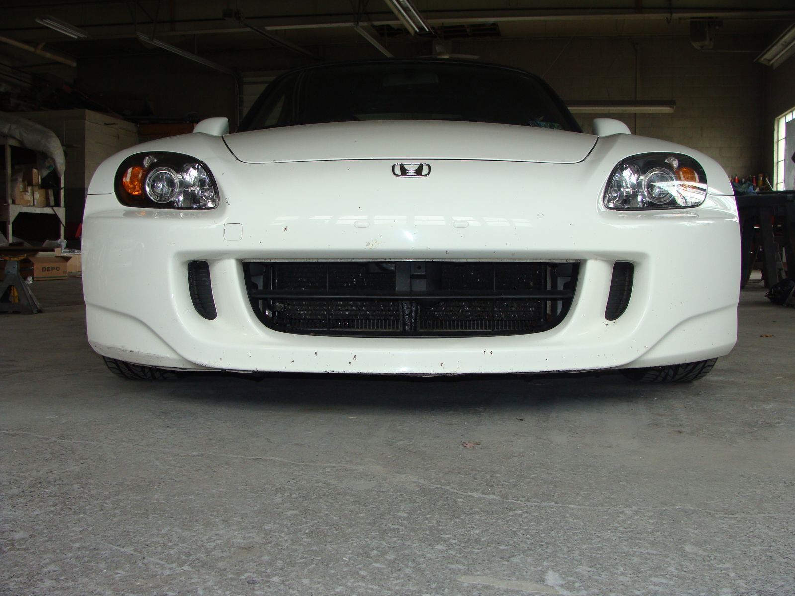

i put in tien flex..i have installed them and lowered th car..its raked at this point with 1 inch of tire tuck in front an half inch in rear
i just put it to stiff tonight and tooled around to feel what that is like now i am going to look at the rebound..and i should be aligning the car soon

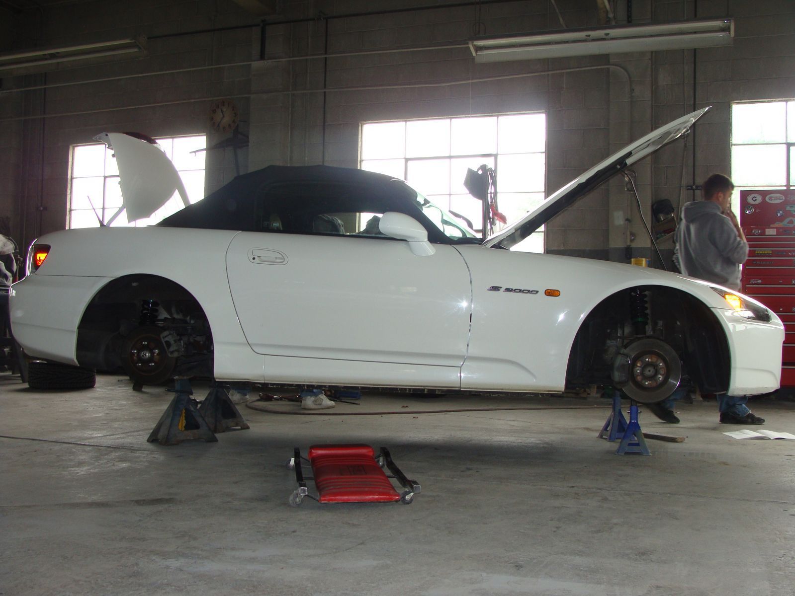

Nice DIY. I used it to do mine this past weekend. Here are some pics...

I thought that you don't have to remove the upper control arm......?

It all depends.....makes it easier if u do...u can be damned if u don't!!!

it makes it easier or you can shimmy it out
