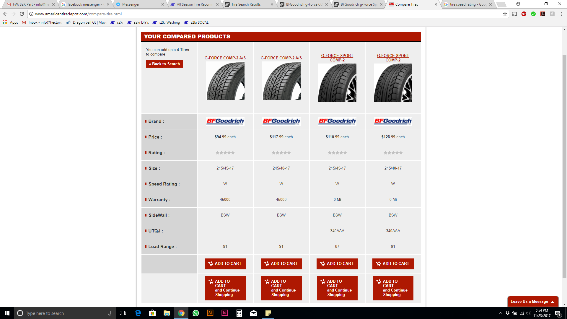

If you end up going with all season tires, I have a set of the BF Goodrich G-Force Comp 2 AS that I have on my oem wheels. I use them in the early and late season when the weather here can be quite cold. In the summer I use a max performance tire. But, I have been very pleasantly surprised by the BF Goodrich G Force 2 AS tires. They really are quite good - they don't give up much to the max performance tires out there and they come in the right sizes to approximate the oem stagger. Sometimes I think I should use them all the time to get the benefit of the better wear rate. Personally, I prefer the oem tire sizes for driving on the street. I think the car is more lively and fun to drive with oem rather then 225/255 and the like. I've done both. Its personal preference, others like big.
