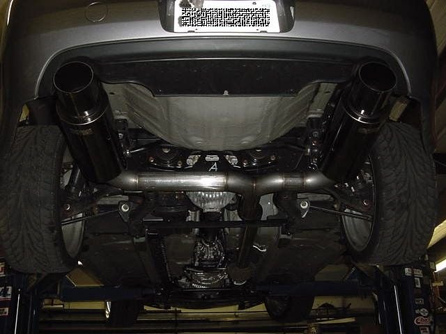

I have decided to purchase a turbo kit for my S. I am not here to debate the pro's and con's of a turbo kit, or to argue about whose kit is better. I need help with the exhaust once installing a turbo. I understand that the pipping for a turbo needs to be 3" to reduce back-pressure to help the turbo spool efficiently. Once I install the turbo what should I do to solve the pipping problem of the exhaust past the cat?
After doing a search and talking to both Stage 6 and Speedcraft both have recommended their dual Apexi exhaust system with 3" pipping. People who have a turbo, what kind of exhaust systems are you using? Are there any benefits, besides saving weight, from using a single outlet exhaust with a turbo?

Just went for a ride yesterday in my buddy's(PA S2000) speedcraft turboed S2000. He is running the Apexi exhaust system w/ 3" downpiping that you speek of. The exhaust is very very loud w/ a deafening drone around 5rpms. I was not able to keep a conversation with him above 4500rpms the exhaust is that loud, however i think the speedcraft kit is put together very well & his car makes some wonderful noises. He was only running 6psi yesterday on pump gas, he said on race fuel w/ boost turned up to 8psi the exhaust is even louder then what i encountered yesterday , good luck w/ turbo

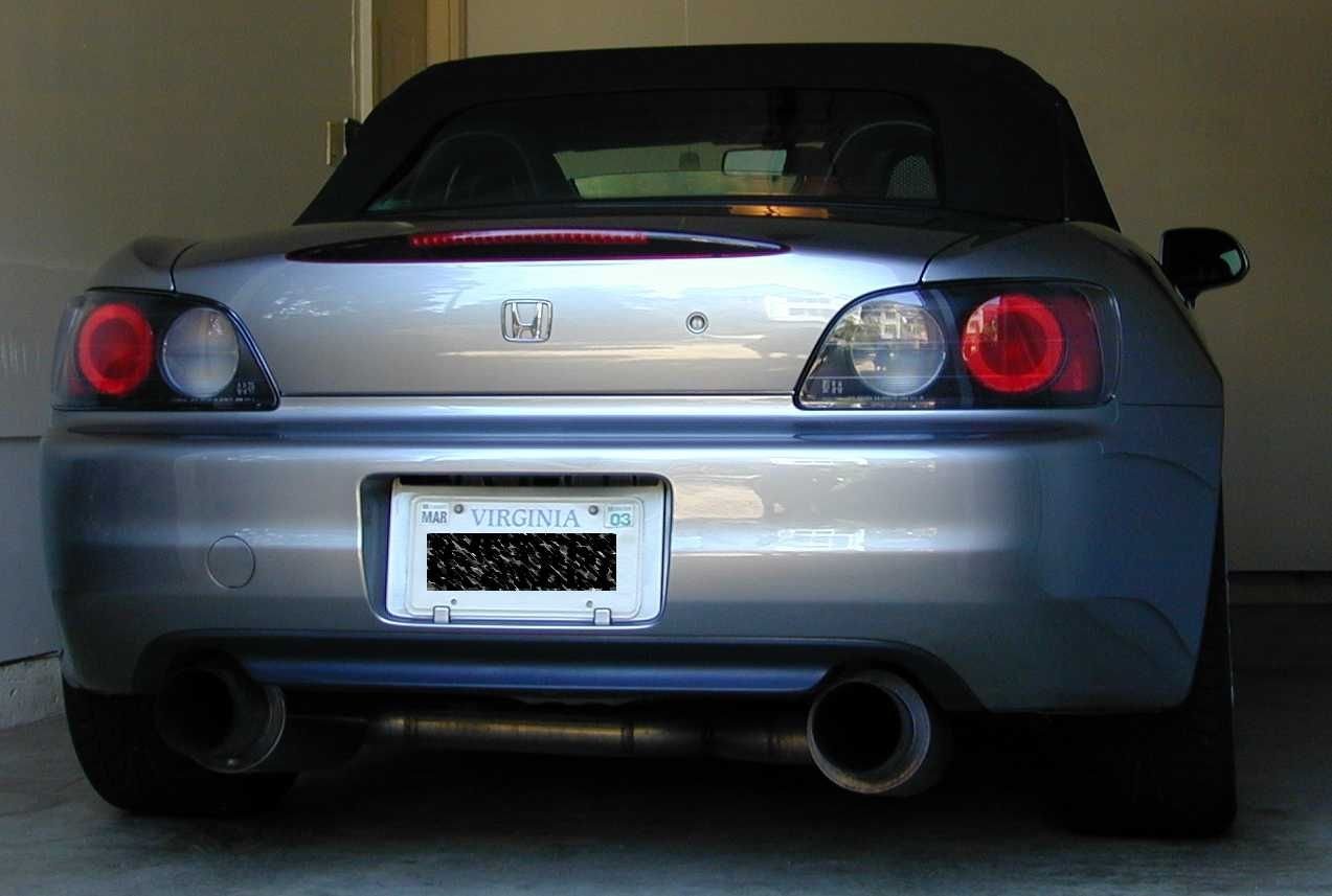

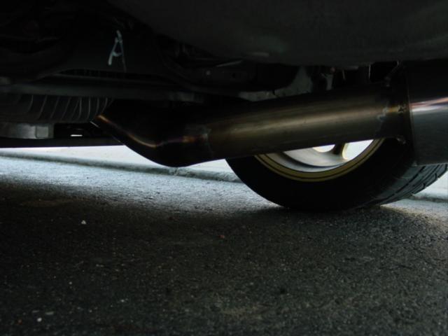

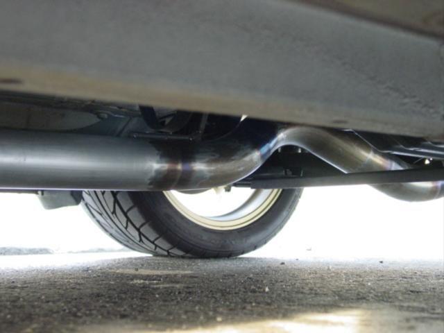

Here's what I did... 3" custom single output with VERY few mandrel bends.
-Larry
P.S. - Sounds great, works better!

BlackS2000turbo-Great pics!!! Did you paint the exhaust?
I seem to remember a thread that documented the installation of a Speedcraft kit, if I recall that was you right? Do you use a VAFC? What kind of cannister are you using? Am I correct to assume that you would recommend the single exhaust route over dual?

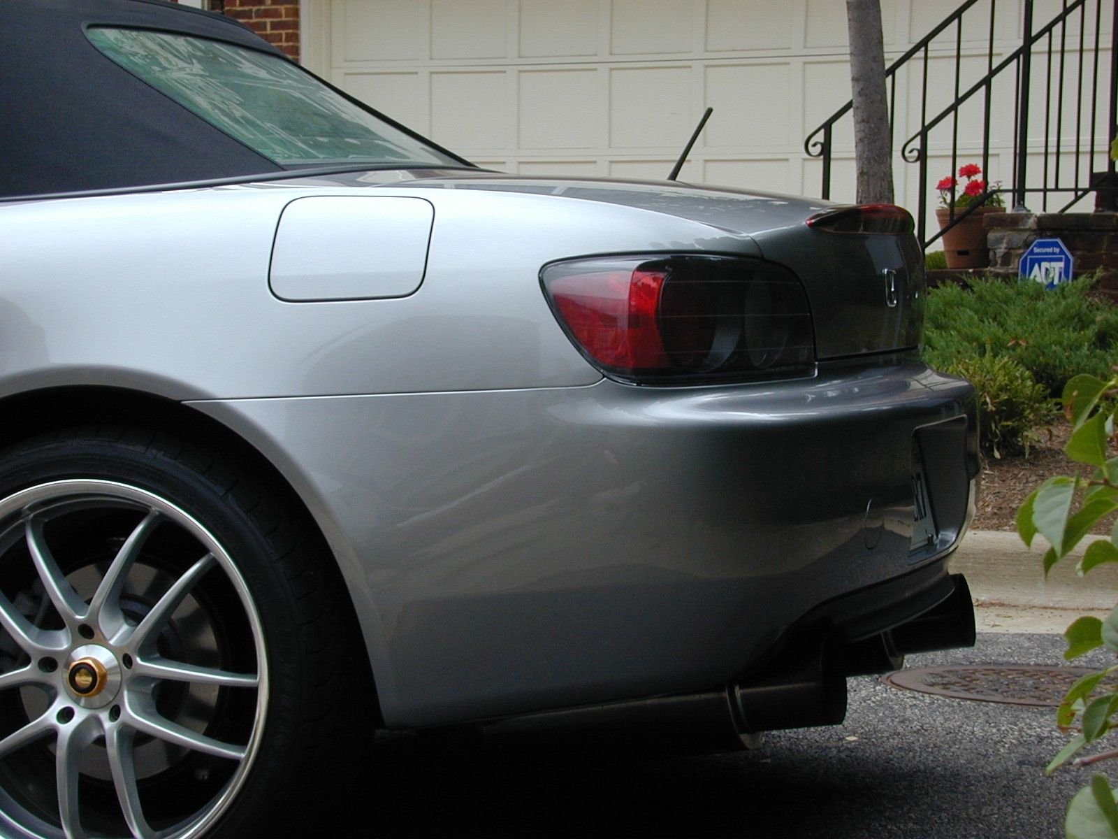

...here is some pics of my setup. For those who havent seen it.
Now I have been told that regardless of whether or not you decide to go with one or two apex mufflers, that the noise level is very loud. I like the sound of my apex however its sometimes annoying,...and I wish that there was someway that I could reduce the noise level without sacrificing power (using a silencer, or cat, etc.)
