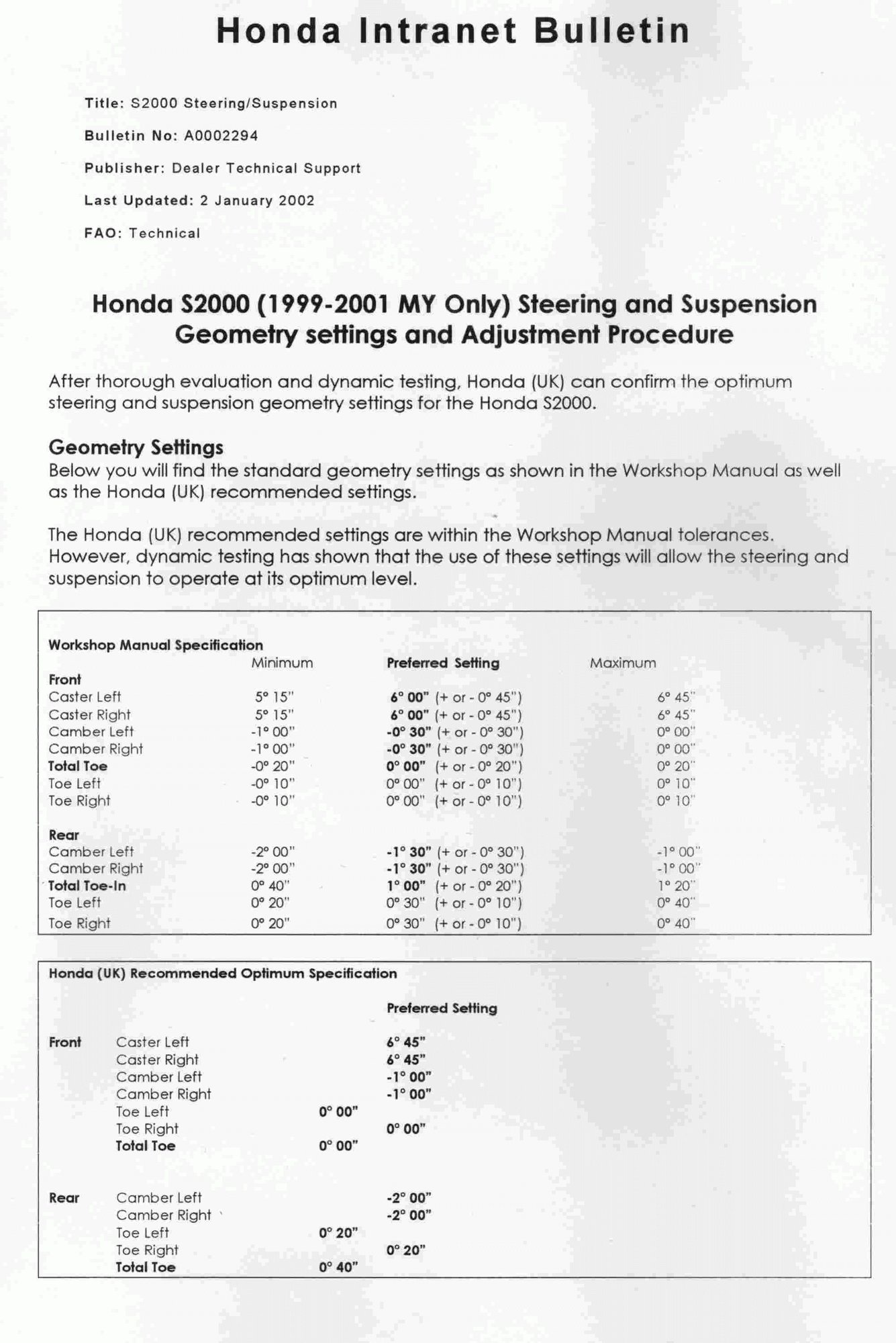

Default UK Spec Rear Toe
Ok, according to this:
The UK spec rear toe is 0

bighead Posted on Jul 10 2007, 07:08 PM
20 seconds is 0.005554 degrees
Exactly!
Look at all the "0" in the decimal seconds.
Do you think that shows up on a allignment computer?
Its way to accurate.
IMO:

s02: 9k
rs2: 10k
re01r: 8-9k (I didn't note my mileage)
but that doesn't answer why it's listed on the bulletin as " which is the symbol for seconds.

bighead Posted on Jul 10 2007, 08:07 PM
True.
Does it matter though?
Look at all the +/- tolerances.
Front camber tolerance = +/- 0
