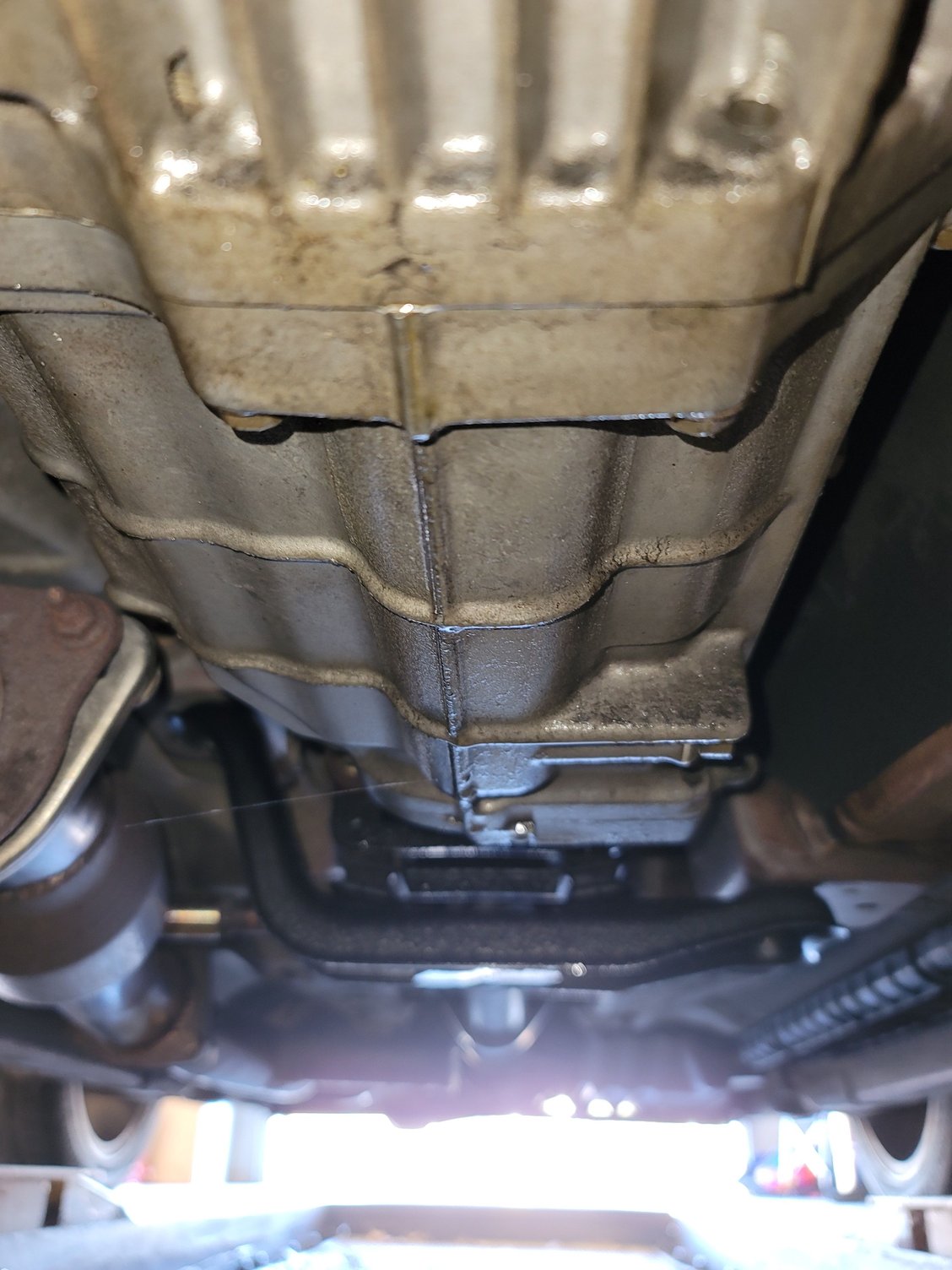

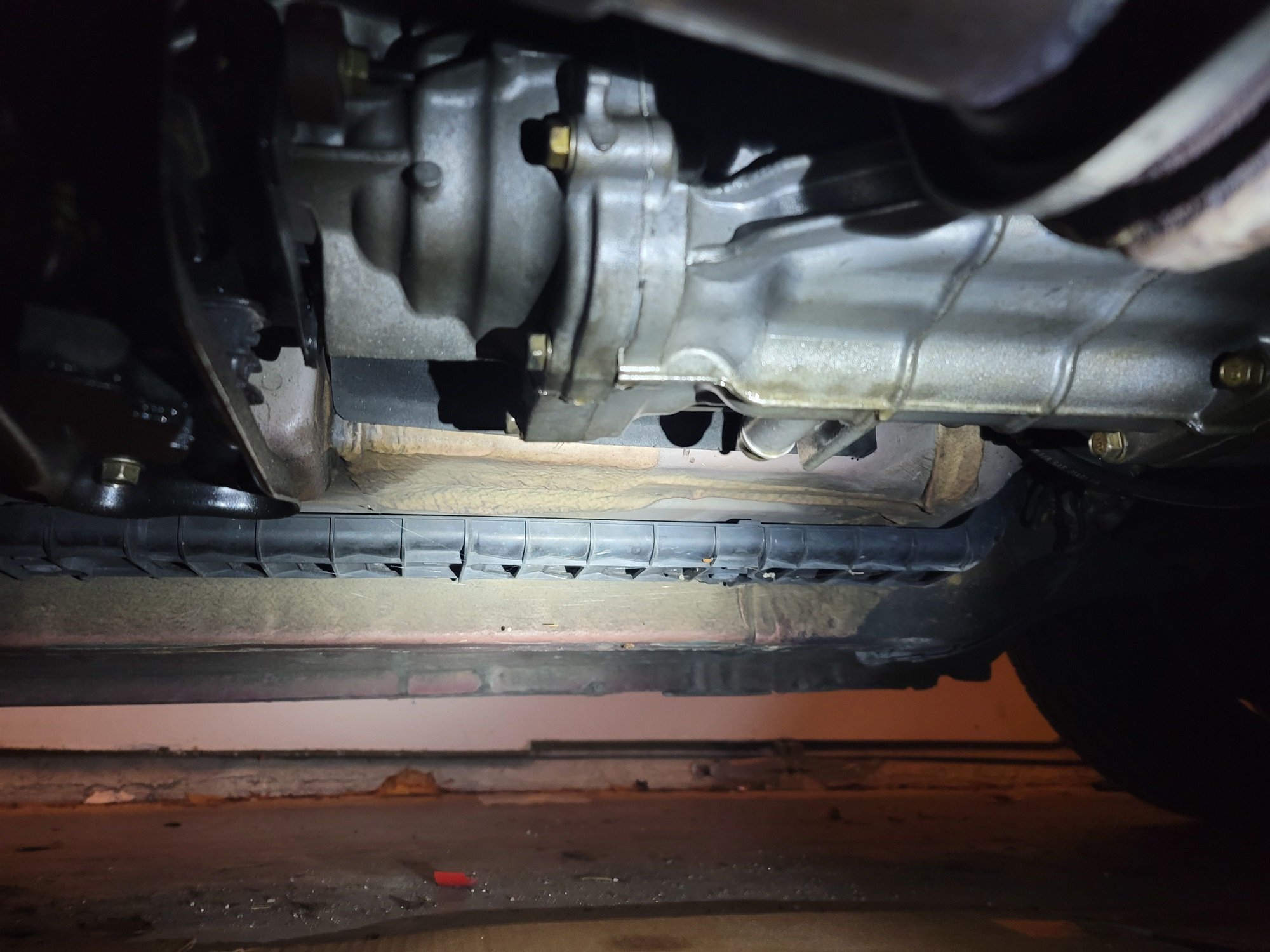

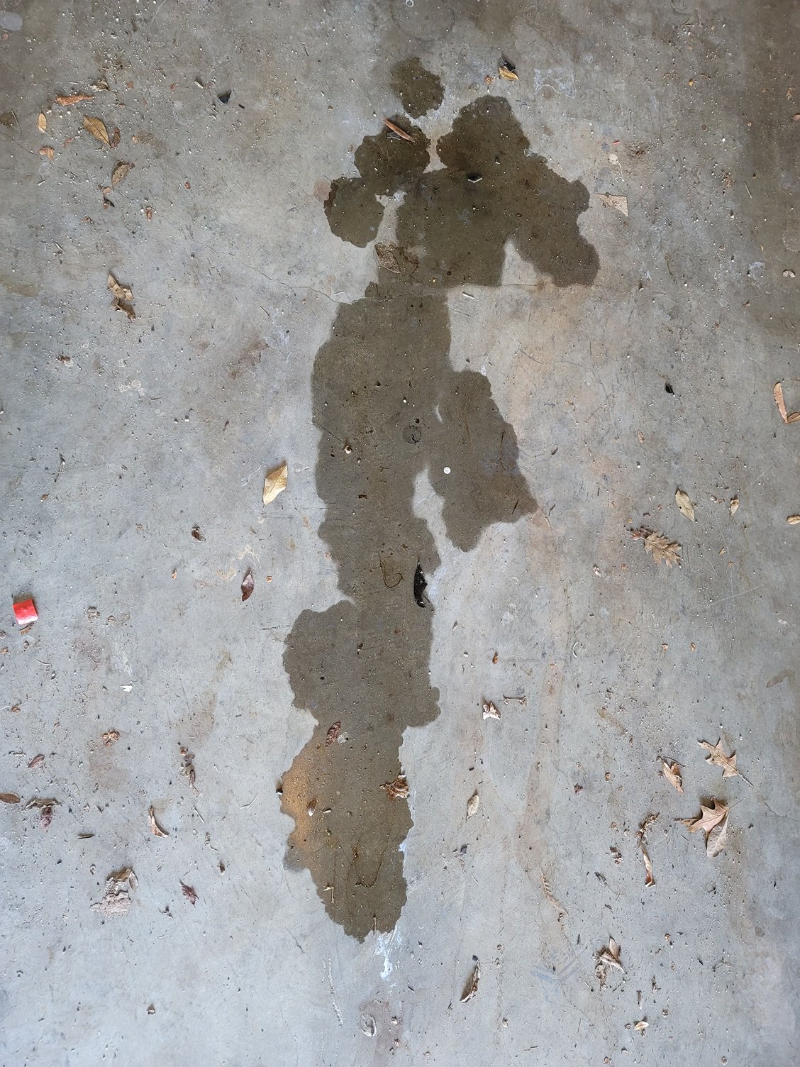

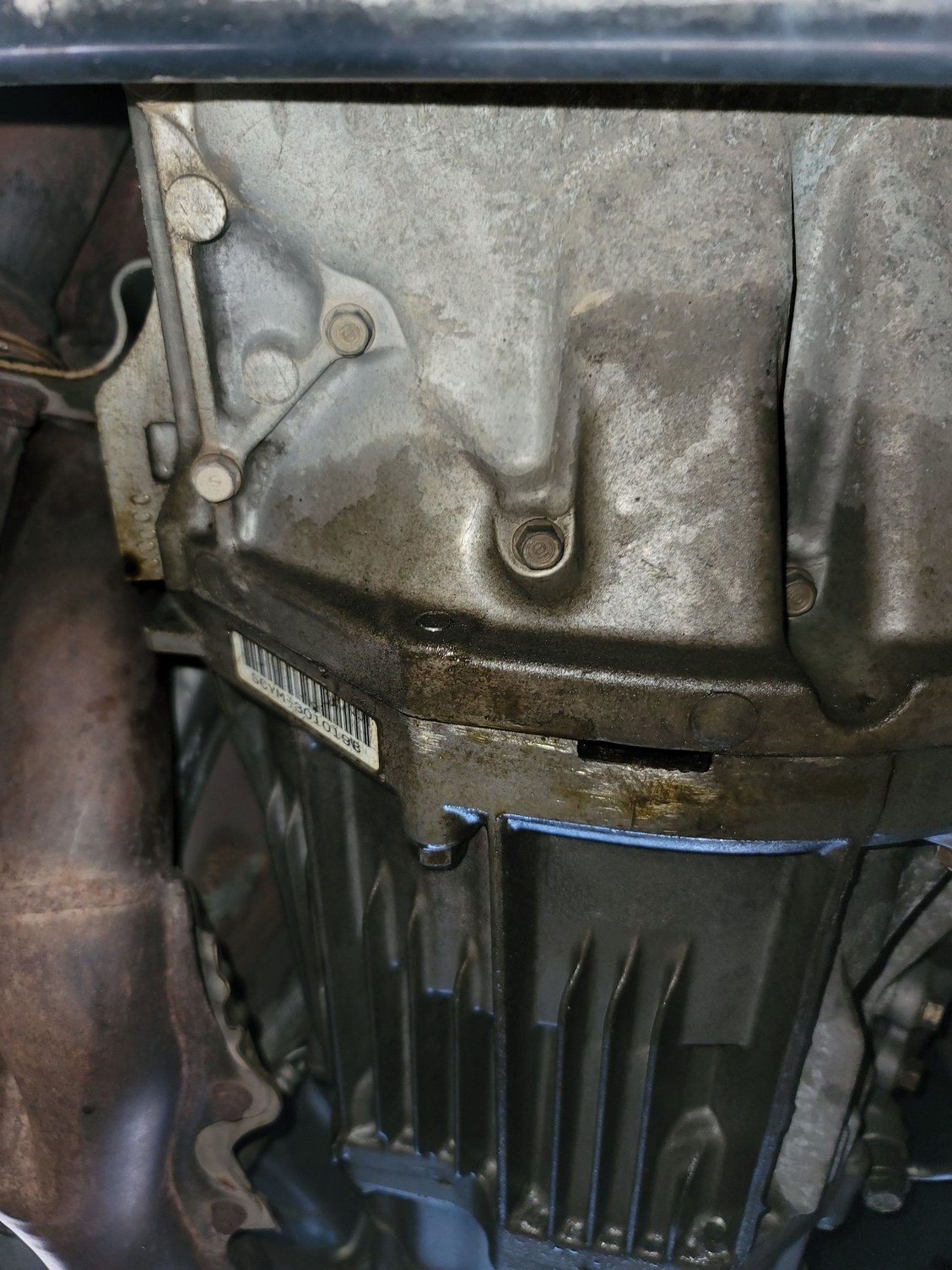

Hello, recently my S2000 has developed a leak. This is about 2 months after changing out all of the fluids. The transmission case was wet. I check fluid levels regulary. Oil, clutch and brake all look good. I do not notice any leaks when driving or when I leave from work. This is mainly after sitting parked for a long enough time. I brought it to the dealer and was told its the vtec solenoid. They wanted $800 to replace it. I have gaskets on the way to change it anyway but I am skeptical that even if it is leaking, would it be causing this much fluid to be leaking out so far away from the solenoid? If not, any ideas on what else it may be? I plan on getting TCT gaskets as well just do not know if those will cause this much fluid to be leaked. Thank you!

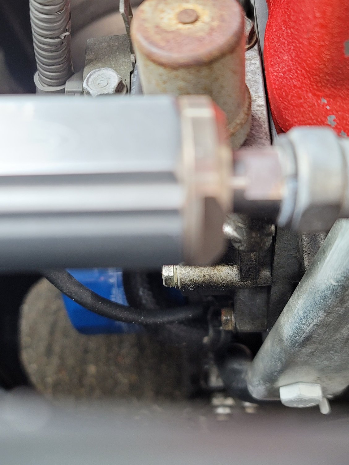

It could absolutely be vtec solenoid. Lets see that area in pictures.

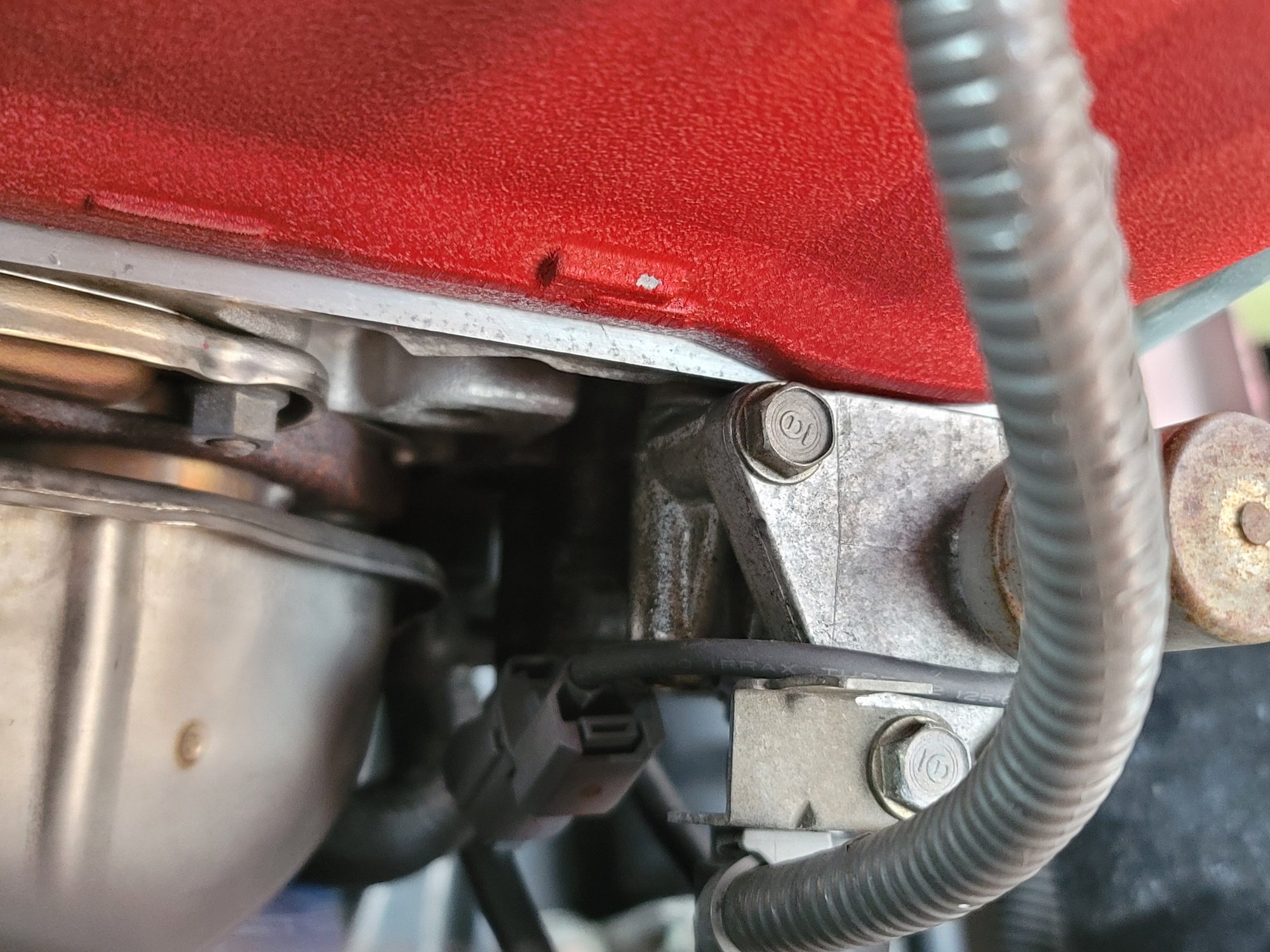

Hope this is clear enough. I can acknowledge there is a leak there it looks a bit wet, I am just unsure if the solenoid would cause much fluid to be on the ground.

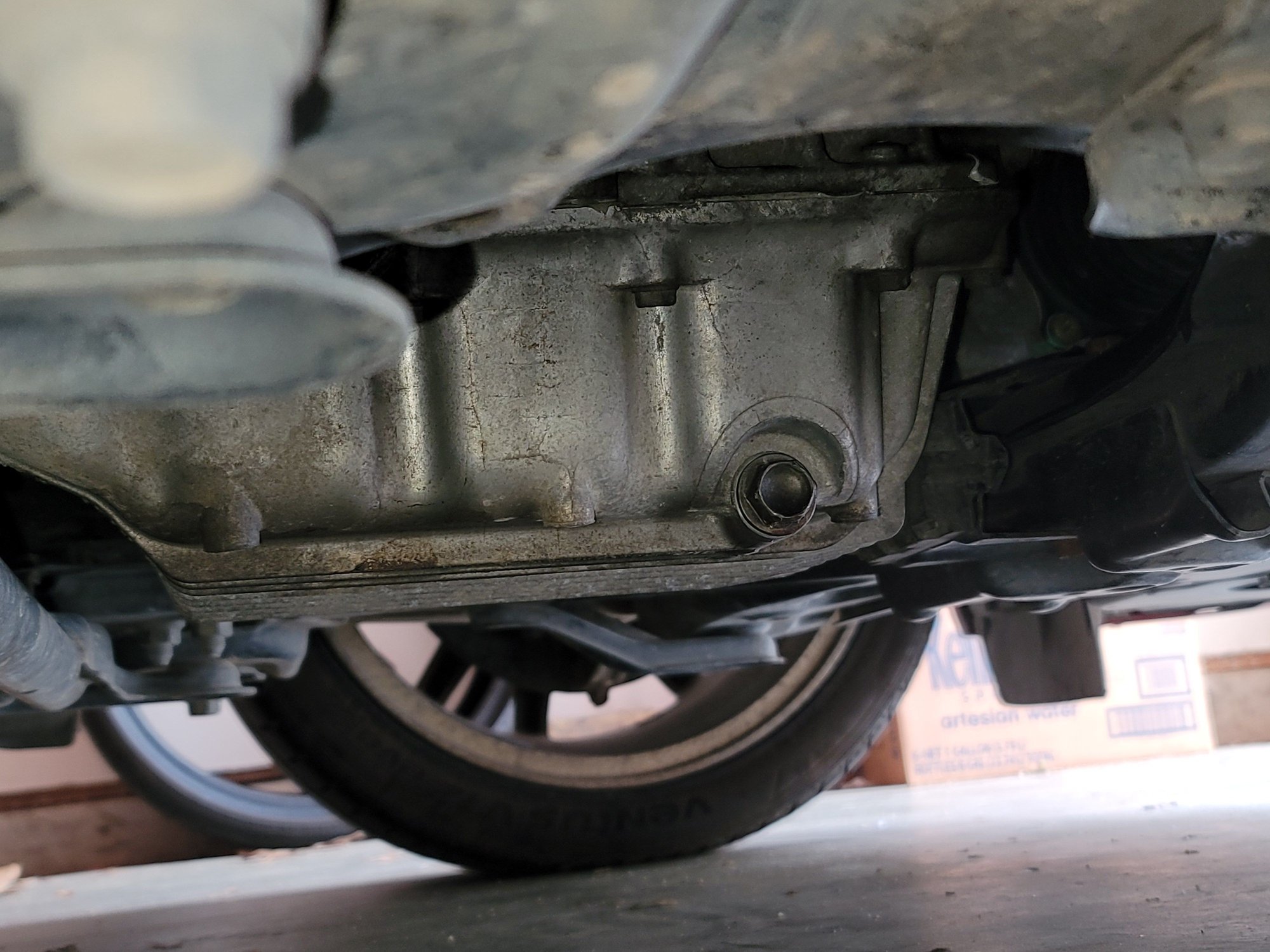

Check your dragon plug washer and your oil filter to be sure they are tight. It does not look like your VTEC solenoid gasket is leaking.
Let's get the easy stuff out the way before going further.

Both look good. Also, I really appreciate everyone who is pitching in!

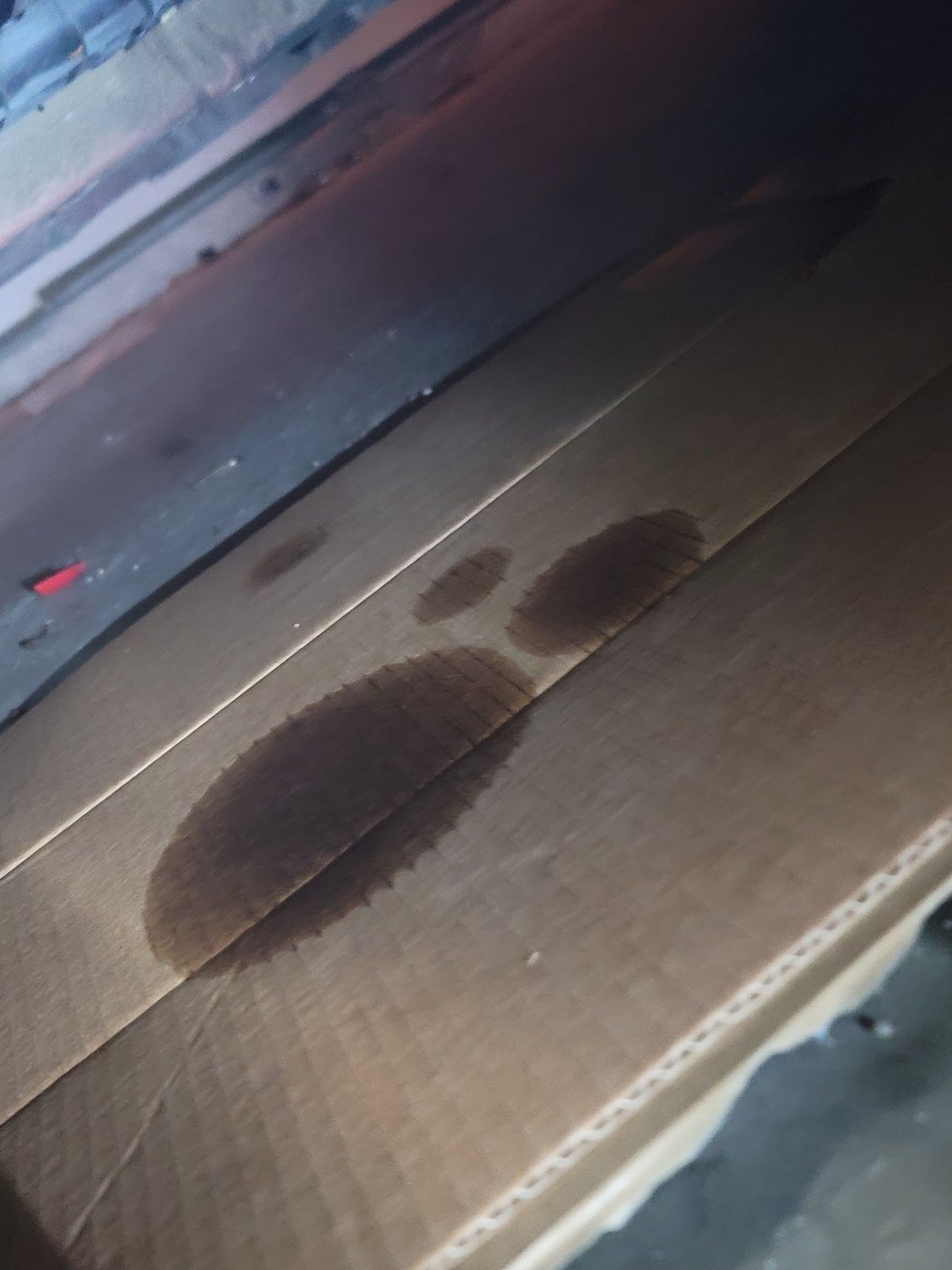

I said the same thing haha. The main seal looks good and the car sat for maybe 2 weeks and caused the big leak pictured above. It has 155k miles on it

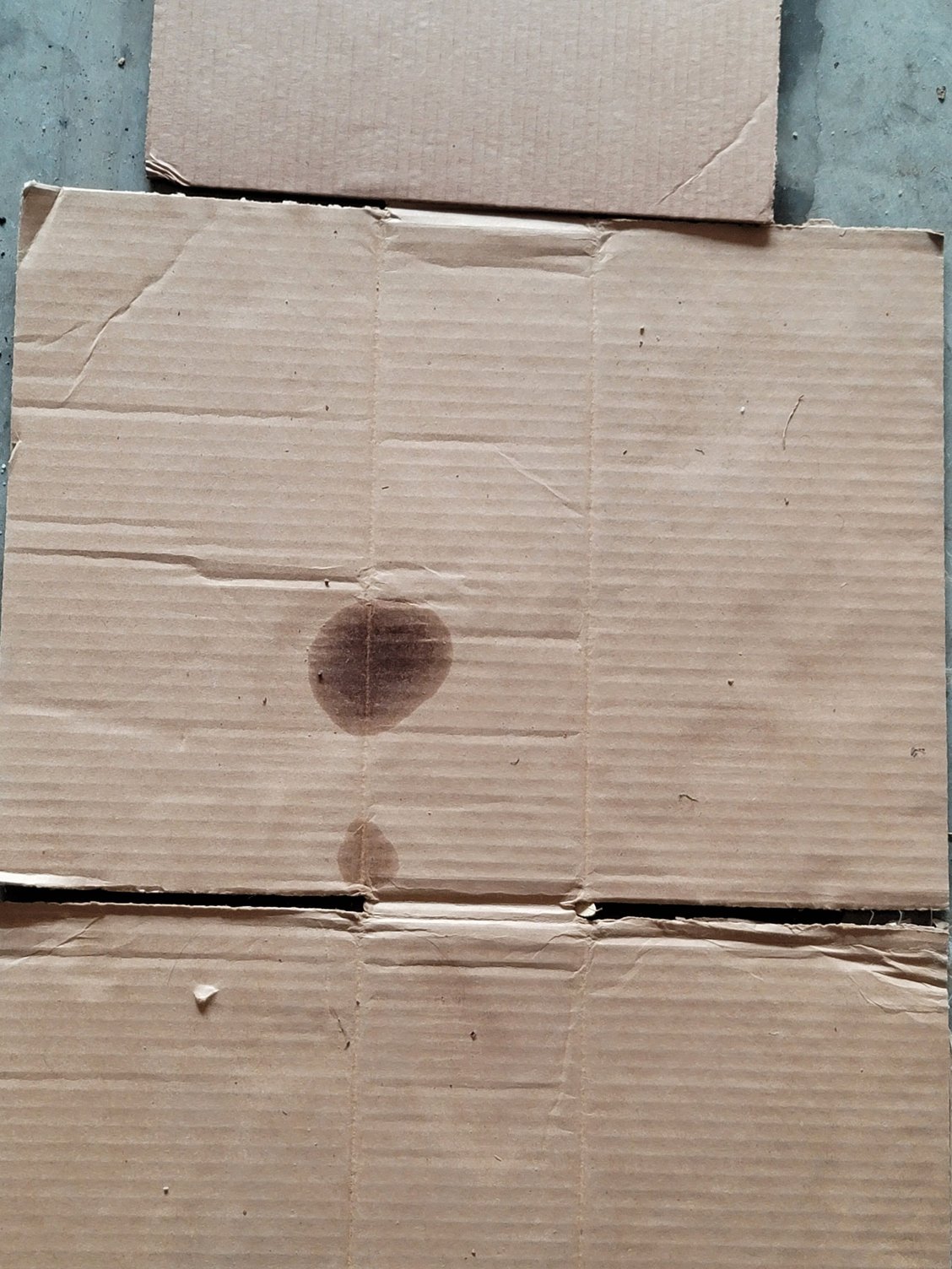

Replaced the solenoid gaskets. Upper gasket was in terrible shape. This is what it looked like after the car sat about 14 hrs after replacing gaskets.
