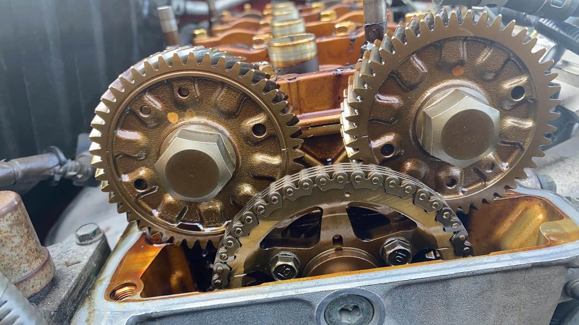

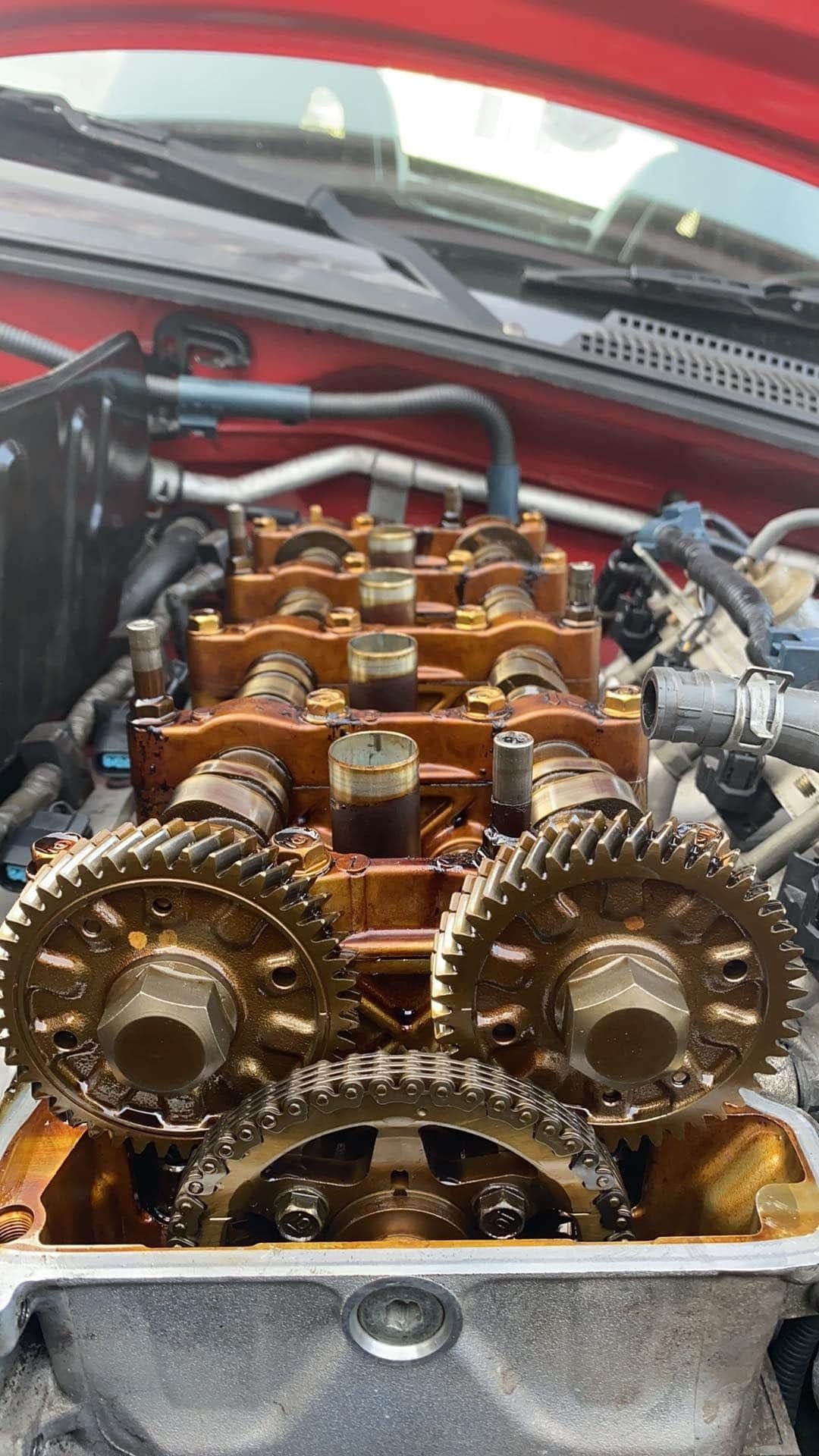

The lines match to my knowledge
The white lines are a few cranks away
The lobes are 11 and 2

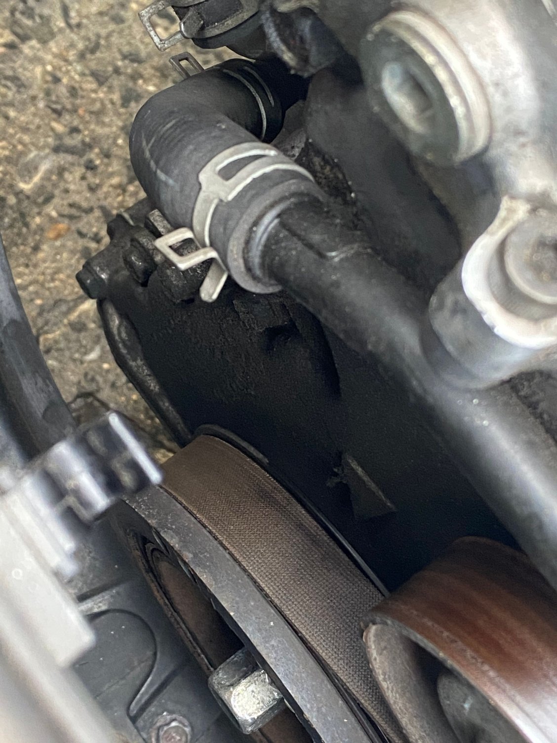

My crank shaft pulley and cam shafts don’t match up the car hasn’t been taken apart yet. The car has 150k miles on it. Should I mark the crank shaft pulley my self and put back to together that way?

Time for a new crank pulley,as its rubber is twisted.
should I use that as a TDC mark?
Old Jul 18, 2020 | 03:27 PM
noodels's Avatar
Joined: Nov 2013
Posts: 6,326
Likes: 612
From: Norfolk UK
put a new belt on also it looks fcukd
