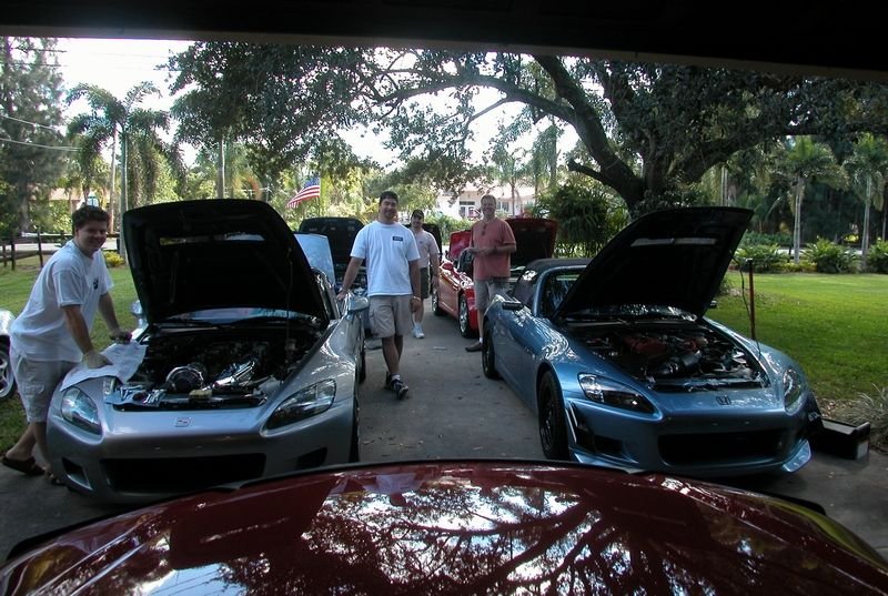

I enjoyed everyone's company and was happy to host the event. It was interesting to see the range of valve clearances present in the various cars.
Valve clearance specified by Honda are 0.008-0.010" for the intake valves and 0.010-0.012" for the exhaust valves. A consistent pattern was that every car had clearances set near the upper end of this range, or slightly over. We chose to stay within spec, but at the lower end of that range. Honda has a 105k mile recommended service interval for valve clearance checking, and I suspect that the larger clearances measured in these cars are designed to accommodate that long interval. With more frequent adjustment, I am comfortable running tighter tolerances.
"Optimal Operation" could have several meanings; do you want maximum power, or longer service intervals. The theory is that tighter valve clearances allow for greater valve lift and duration, resulting in slight power improvement. However, if valves get too tight, they do not cool as efficiently and that could lead to valve train problems. I'm speculating, but it may lead to increased likelihood to float the valve - anyone with knowledge able to comment?
Photos to follow ...

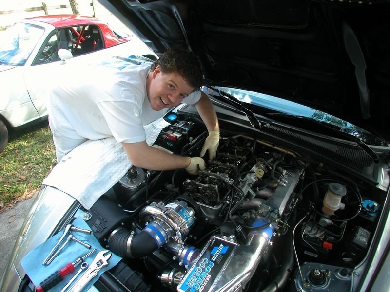

A big thanks to Josh for hosting and sharing his experience. I adjusted my own car and bigpurp's (shown in the pic above), and had never done a valve adjustment previously. It's somewhat tedious when you take the time to do it right (what isn't), but it's not a difficult task.
On the drive home, I thought the car was running quite a bit smoother, and idle is VERY quiet. I also felt like the car was more eager on the non-VTEC cam lobes (like Russ mentioned above). Since temps had dropped 25 degrees since noon, I figured the weather probably had more to do with it. But on the way to work this morning, temps were already back in the 70s and I got the same impression.
Most of my valves adjusted down .002 or .003", which would give more lift and increased airflow. Wouldn't it make sense that any improvement would be more apparent on the non-vtec cams, since the adjustment is larger relative to the lift height?
