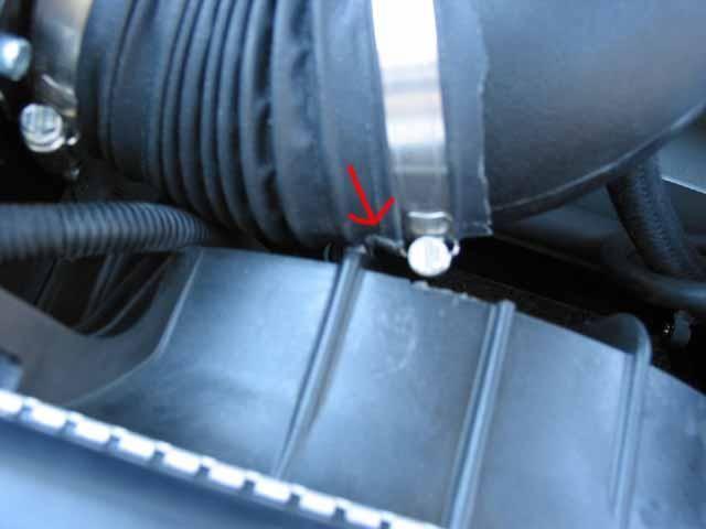

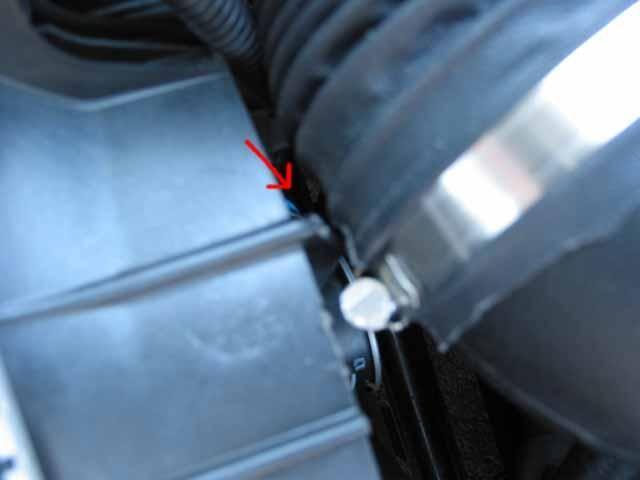

Just wanted to point this out to prevent it from happening to others.
The flexihose between the K&N airfilter and the supercharger was rubbing against a fin on my radiator fan. I noticed it in time before it wore a hole in the flexihose and cut down the plastic fin on the fan with a knife.
