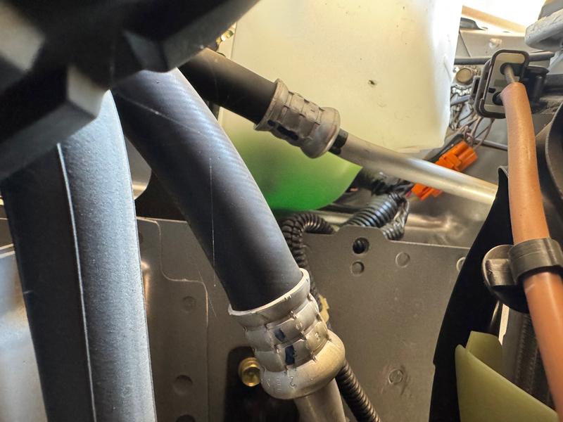

I bought my '03 S2000 new and just cleared 10k miles. It still has the original green coolant in it, so it's time (really past time) that I change it out. From what I've read, I need to go with the Honda blue Type 2 coolant, but what hoses should I change? I figure that I need to replace the upper and lower radiator hoses, but what others would it be advisable to do at the same time?

Originally Posted by JBamin
you bought it new and it has green coolant in it? it should have never had green in it. they stopped doin green in the 90's.
It's definitely green and is the original coolant. I bought the car new and literally nobody else has ever worked on the car except one guy who changed the tires.
Maybe someone topped off your coolant at some point with the green stuff? As everyone said it would be blue if it were original.
100% it came that way and nobody else has worked on my S2000. The information you have about it being blue is incorrect. Below is a thread where others confirm that the coolant was originally green. I don't know when they changed over to blue.
What Color Is The Coolant That Originally Came In Your Car? - S2KI Honda S2000 Forums
I stand corrected! Thank you.
