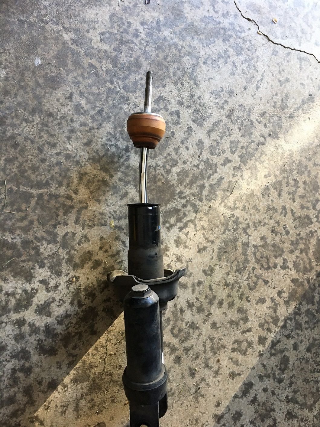

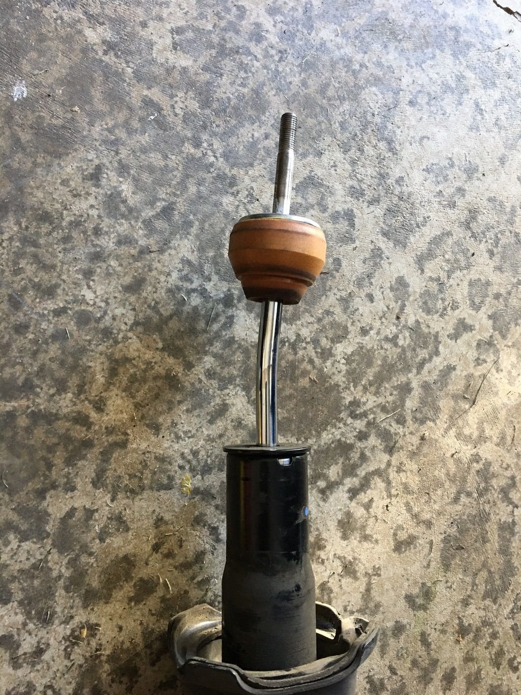

Well I decided to take both of the rear struts apart, and this is what I found from the DRIVER side, which would be the inside wheel when making the lefthand turns. Not what I was expecting, but definitely seems to be a problem! Gonna have to order a used rear strut from this side as well now.
Old Jun 18, 2020 | 10:54 AM
noodels's Avatar
Joined: Nov 2013
Posts: 6,338
Likes: 617
From: Norfolk UK
Glad you found the culprit
Old Jun 18, 2020 | 10:57 AM
LagunaPearlAP2's Avatar
Joined: Jun 2016
Posts: 289
Likes: 49
From: Vancouver, WA
Only when I get the new struts and install will I know for sure... but this definitely feels good to see something obviously wrong I was a bit surprised when I took off my passenger side strut (which I suspected to be blown) and found it to look and feel totally fine.
Old Jun 18, 2020 | 12:18 PM
Deckoz's Avatar
Joined: Jun 2018
Posts: 714
Likes: 158
Oh wow, yea that'll make some funny feelings in the butt dyno/stability sensor
