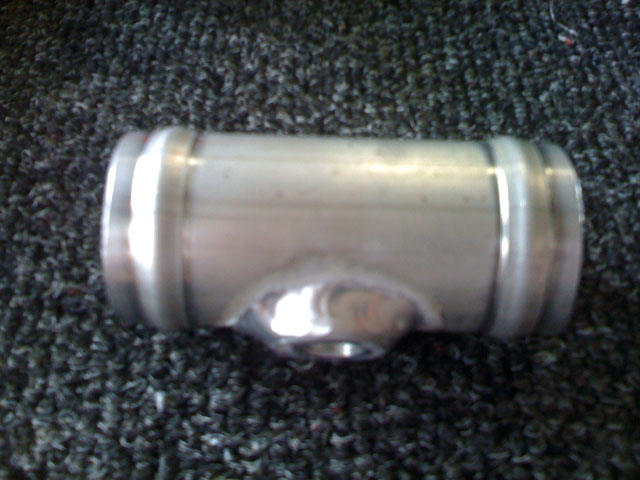

well easy. cut the upper rad hose and install an adapter in between them. This will allow you to hook up the temp sensor probe. Here's a picture of it. Keep in mind this is not the right size but just the idea of what it looks like.
http://www.performanceautowerks.com/Produc...er/Coolant1.jpg
