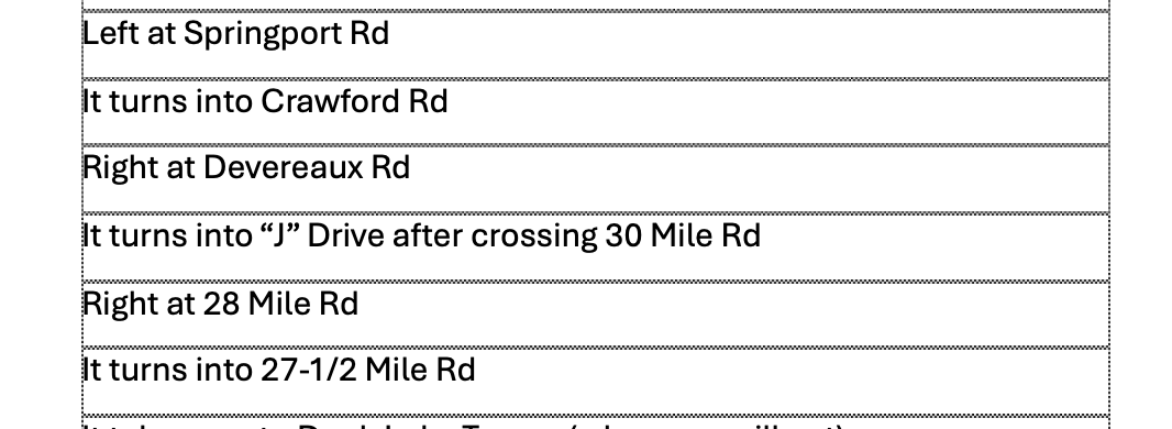

Does anyone know how to remove the lines that appear on Word documents? They only appear when you create the page but do not appear when the page is printed. For the life of me I can not find a way to turn them off.

Thanks Lainey, I am pretty damn sure you hit the right area. These damn guidelines appear with every new document and even my older documents. There are at least three areas I know of which have impact: Page Borders, Paragraph Borders, and Auto Correct Borders. I have tried and tried and tried to deselect each area with "no borders" but it never works.
I have been using Word for at least 40 years but this has me stumped.

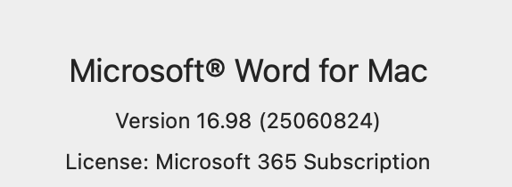

Which version of Word are you using?
Old Jun 28, 2025 | 07:18 PM
dlq04's Avatar
Joined: Jan 2001
Posts: 45,834
Likes: 8,340
From: Mish-she-gan
