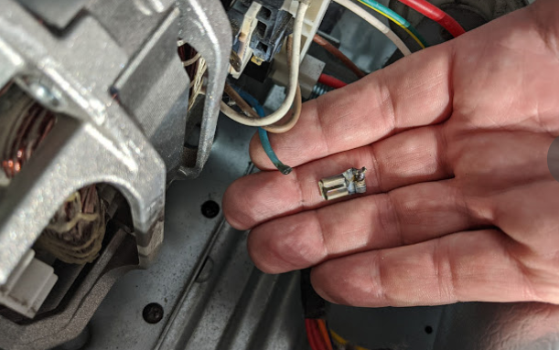

The dryer repair worked for a while before it rolled over and played dead.
This time a different failure mode But i went back to my old guy for repair, ME.
I learned a few quick things from repair guy last time which made it easier.
Sometimes failures are self evident.
Like this one.
It appears to be going to the starter cap which I suspect is toast.
Of course parts lists don't include starter caps just motors. ( $196)
this is where not having a schematic is tedious.
I hear clicking from the control board. need to dive deeper.
Control board is $280. service call by tech is $175 to show up.
Did a quick query on home despot, found I maytag I like, back ordered until june 7
wonder if the neighbors would mind a clothes line for a while.

If you know the size of the cap it is available on line. You can also check the cap with a meter.

can't quite see it. i also need to make sure relay is giving motor power.
then I'l get more ambitious and pull the motor.
