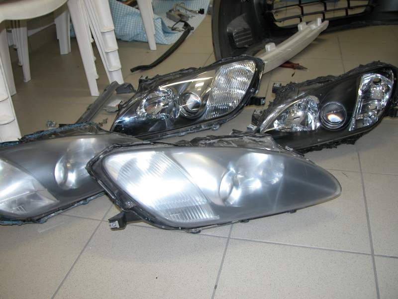

I was polishing my headlights as well last weekend, you can see a pic that shows headlights sanded and headlights polished....
You heart becomes quite small when you only have sanded headlights
