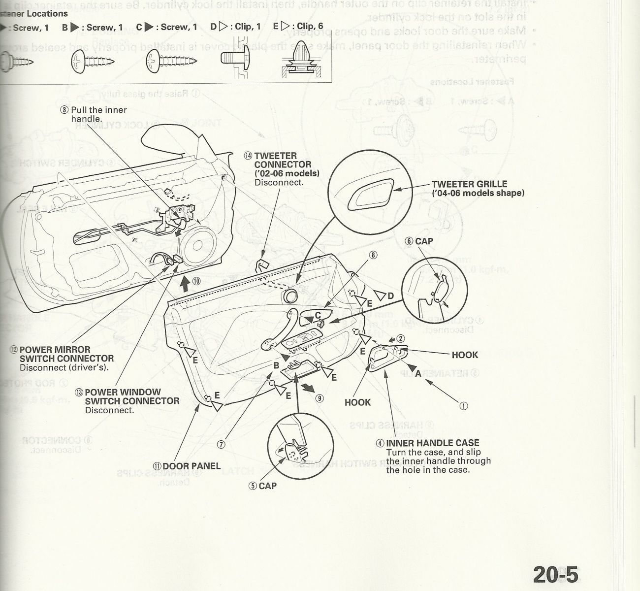

hey san diego. i have a weird predicament. my passenger side keyhole seems to have been knocked into the door itself. Right now, everytime i close my door, i hear a bad rattling sound (keyhole cylinder moving around in there?). Also, now there's a gaping hole where the keyhole should be. Does anybody know why this would happen? and how do i get this fixed?

take the door panel off theres plenty of room to get in there

Just putting my new book to good use and helping out our S2KI community

actually, that diagram really did help me. i was able to pop the cylinder back into the hole. thank you s2ki
