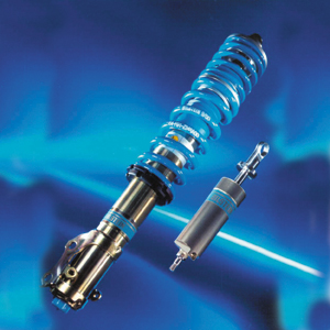

For me its been BILSTEIN PSS since i switched from springs to a coilover system. Its been good to me and handled great which is something the Germans have over the Japs "Handling" The PSS is your average Coilover system with 2 springs, The actual spring and the lower helper spring, its a simple function with hight adjustability and no damper setting option unlike the PSS9 I have no complains about Bilstein and has treated my ride very well and handling ofcourse. But for me its time to move on and looking into a wider based coilover with the height adjusting, shock adjusting height and the dampering feature, so that i can get in more tune with the Suspension world
