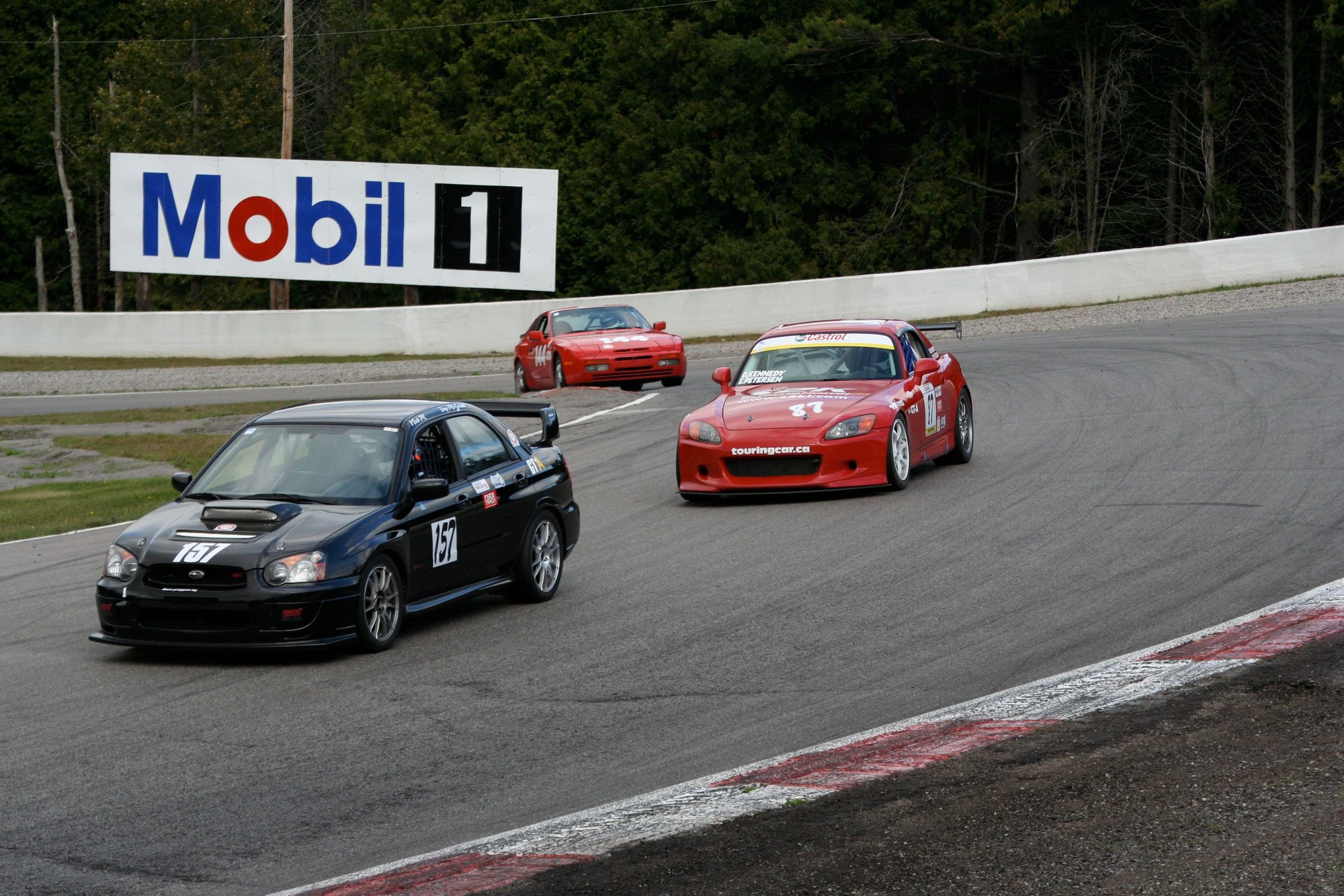

I have some experience with an S2000 track car you might say
If you are into taking your car to the track and lapping but aren't yet ready to graduate to the real deal of racing wheel to wheel have you looked into Solo Sprint events? http://www.casc.on.ca/solo1.php
The S2000 is a lot of fun on the track. It's well balanced and nimble. Unless you are competing then there is no practical difference between the AP1 and the AP2. Suspension geometry changes are minor and can be replicated with a set of rear toe links (aka bump steer kit) on an AP1 but they are also recommended for an AP2. The main advantage of an AP1 is price. You can buy one for about $10K in the US. A used low milage F22C engine runs about $4000 USD.
The S2000 is a VERY simple car. Compared to your S4 it's like working on a bicycle. For about $300 in tools you can do 90% of all maintenance in your garage and most of that maintenance takes less than an hour. There are no complex electronics, no electronic do-dads, no complex computer reprogramming. Change the fluids, change the brakes. Nothing a circus monkey can't do, all you need to know is how to turn a wrench (of which you need only a few: 10mm, 12mm, 14mm, 17mm, 19mm to do virtually everything). For everything else there are plenty of Honda shops around including Speedstar to help you. This is a huge plus for a track car. You can spend that money on tires and entry fees.
You will probably need a rollbar installed. There are a few options out there but not many. The ones that do exist are geared towards maintaining the interior. Since this is a track car I suggest you gut the interior and install a hardtop. Have a custom rollbar fabricated which can be converted to a full cage (not hard) in the future. You can have it built to specification and even have the seatbelts remounted to the bar so you can keep the passenger seat but replace the driver seat with a racing shell and 6pt harness. This will run you about $1500 for the custom bar and you can get a nice bucket and harness for about $700 more. Gutting the interior will save you about 400 pounds which doesn't sound like much but it's 2 full sized adult males and will have a significant impact on speed and handling.
A track car have be somewhat unreliable. I suggest you also invest in a pickup truck and an open-deck trailer. You can get a 97-01 F150 pickup for a couple thousand dollars and a used trailer for about a grand more. $3000ish will give you the piece of mind of knowing that you'll always get home regardless of the condition of the car. It doesn't take much to make you trip home problematic, a coil pack, a blown engine, a cracked rotor, it could be nothing more than a $50 part which leaves you stranded. With a trailer you can end the day the same way every time. You take the car home and put it away. It's piece of mind knowing that you don't have to scramble or be stressed at a bad time. You can deal with whatever problem you've got either at home or some days later.
So, you've got $10K for the car (in the US), gut it, $1500 for the rollbar, $2000 for the hardtop, $1000 for the seat, harness, tools and bits and $4000 for a pickup truck and trailer; figure $20K complete.
