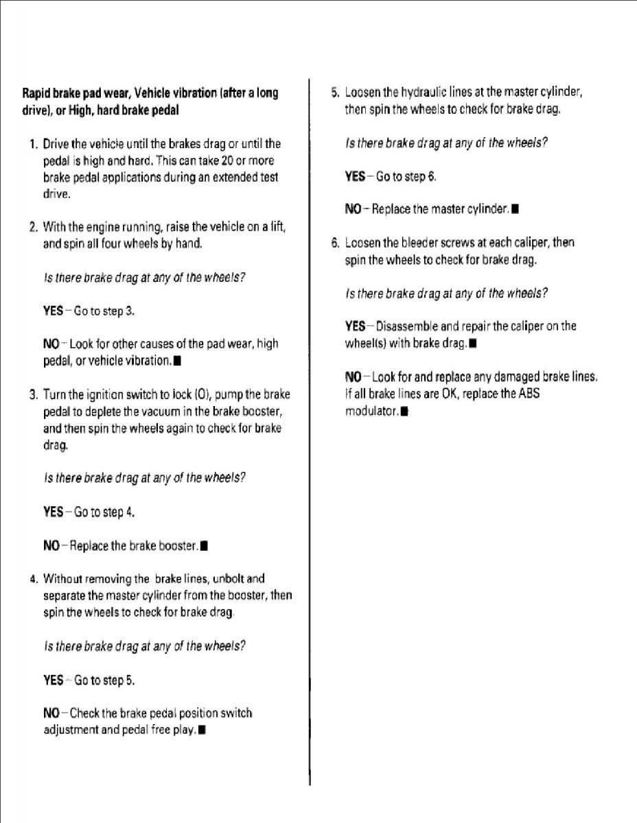

Chris....I will post the troubleshooting sequence from the service manual when I get home.

If you doubl click on the image you can read it better.
The las trouble shhoting step after checking the calipers is if no, check the brake lines and ABS modulator

ok guys, might have made a break thru tonight. we disconnected the brake line and plugged it (no leaks). turned the piston in and drove the car down the street afterwards. left rear is still hanging up. so my thinking is that the e-brake is just too tight on the left side. i am gona disconnect it from that side 2moro to see if that frees up that brake once and for all. once again thank u guys for all of the input. thanx for the skimatic chip. will update 2moro night
