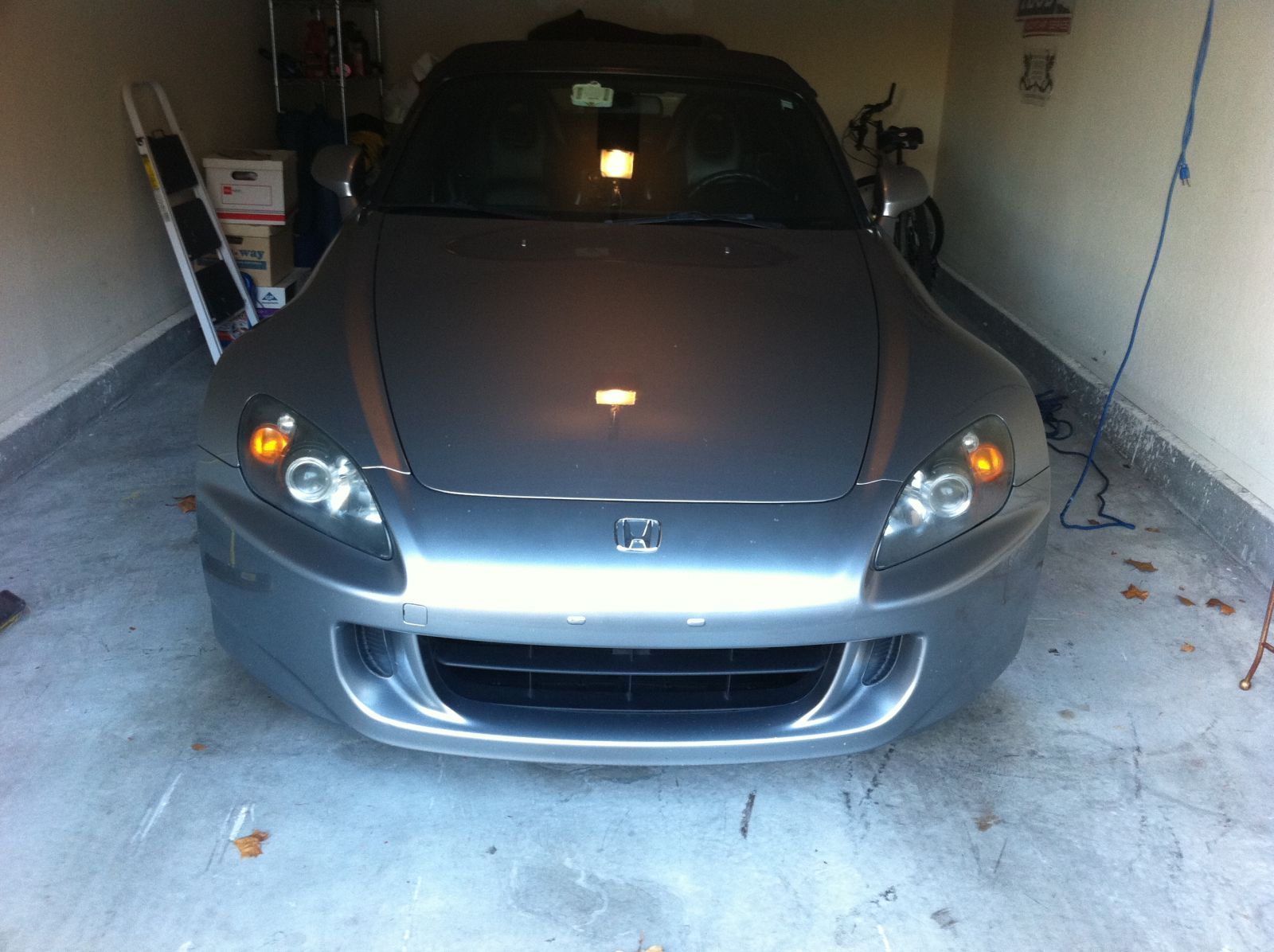

Some people really didn't notice or said they looked fine but I wasn't happy with them, so I decided to restore them.

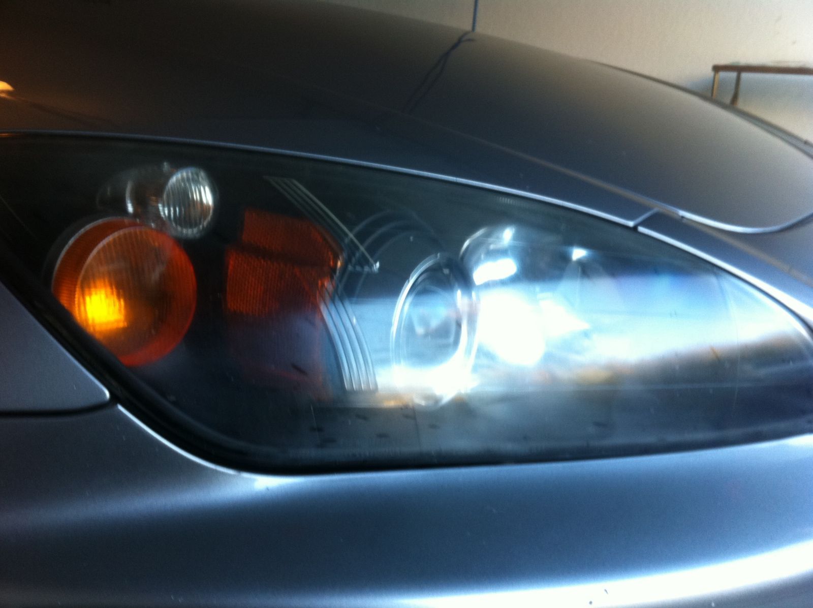

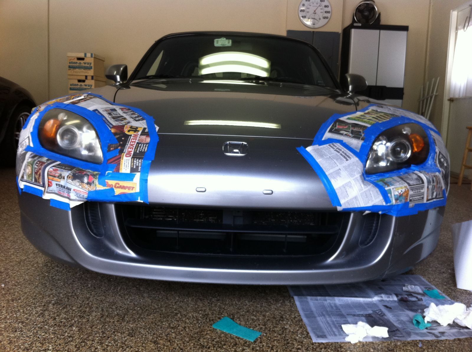

I got the car all taped up and some newspaper, up close and personal this is what the lens looked like..

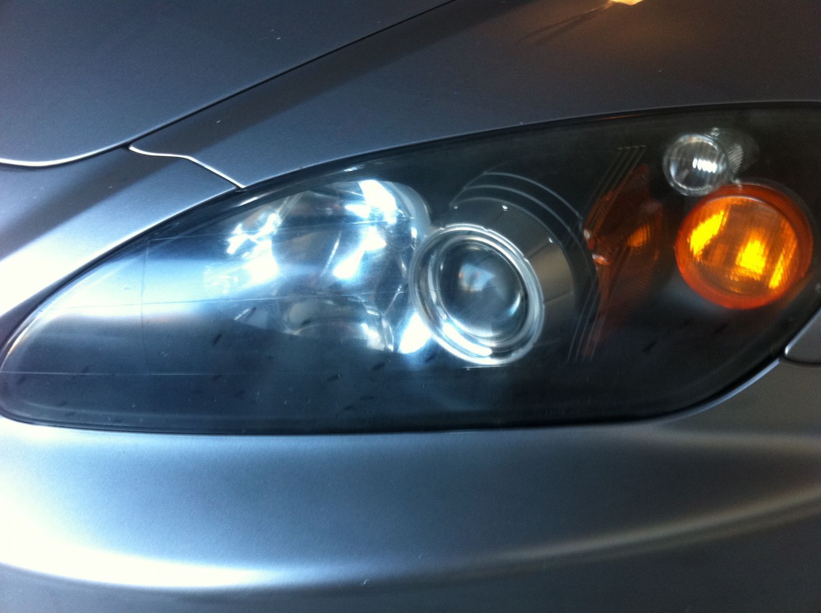

The lens on the left is untreated and the lens on the right is treated..

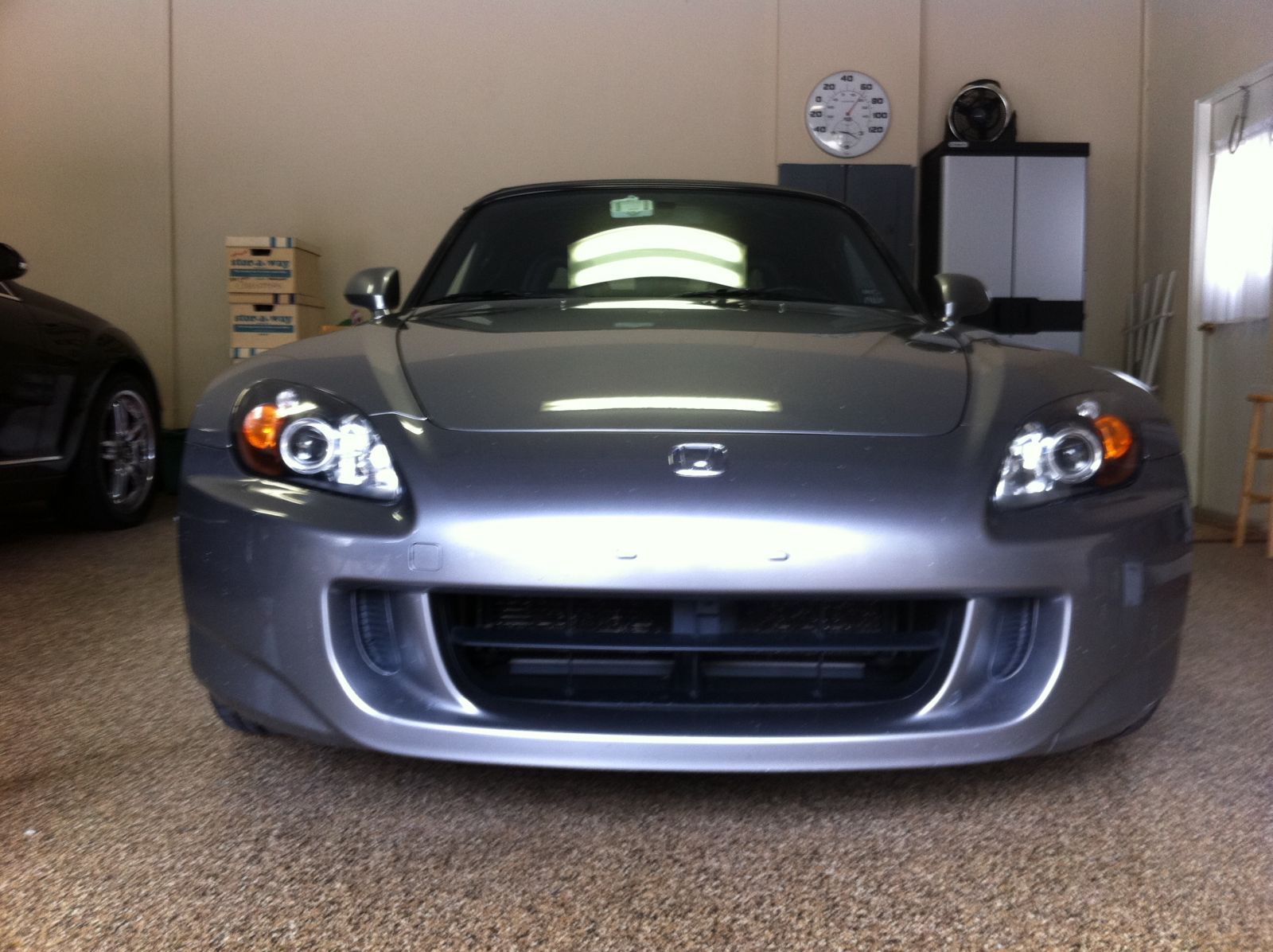

So finally...
OLD
RESTORED
Again OLD
NEW
Now I just have to wash the car! I hope you enjoyed transformation. I did this all in about 2-3 hours.. all before the big game! Pretty simple process, just follow the directions and that's it!

1st Step is have a water spray to spray down the headlights
2nd Step is to spray the Brown Sandpaper given in the bag and for 3 minutes slide the paper back and forth sanding down the lens.. I went for a little longer 5 minutes, make sure to keep the lens wet
3rd step is dry the whole thing off
4th Step is to either repeat step 1 & 2 for more desired look (keep in mind the lens will appear even worse, kinda frightening to be honest) or spray the lens again with this blue sander that's much smoother than the brown one.. keep it wet at all times till finished.. only do this for a minute and dry the lens off again.
5th Step is to apply this application (CV #1) from the package all over the lens and make sure to rub with the given applicator in the package for about a minute dry it again
6th Step is apply this application (CV #2) from the package and make sure to follow the directions because it indications to only apply in a single direction while the given applicator is wet otherwise you will remove the sealant, let the product dry on its own
Switch Sides
After you did the other side return to the 1st Lens and redo the 6th Step for a second coat, wait about 5 minutes to return to the 1st Lens..
****Also make sure you wear the rubber gloves provided in the package... I've heard it can do some damage to the skin!
Have fun! It was totally worth it!!
