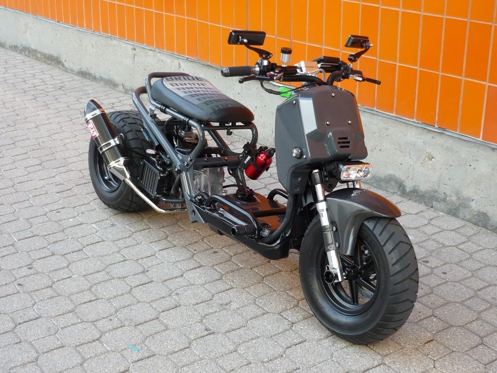

Alleykat 09' Ruckus:
Engine:
Polini variator
K&N filters
Daytona belt
Posh CDI unlimited
Yoshimura carbon exhaust,Bowls modified for fatty
Frame:
Kandy Jollypop Copper powdercoat rear frame & triple tree
Satin black powdercoated main frame
Custom chopped/extended seat frame
Custom shaved headlight bracket,powdercoated
Custom chopped NCY footbrace w/powdercoated pegs
Custom chopped/shortened powdercoated side pegs
