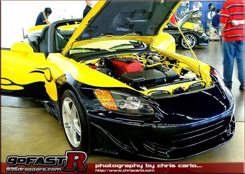

Kevin's right. I have a friend who used to detail most of the used cars for dealers in Dallas. He gave me a $400 buffer and some valuable information on buffing. I usually leave it at the lowest speed (it will burn VERY fast, I learned this on my freshly painted bodykit the first time I used it) and you hardly use any pressure. There is a polish called 3M Finesse-It II which is about $40 a bottle that is found at paint supply stores. You have to use the black foam pads (the blue is rougher and will be too rough for removing swirls. It will probably install them in your paint, hehe) The Finesse It II is THE BEST product I've ever used, and I get lots of compliments when used in conjuction with the 3M Show Car Wax. Oddly enough, this is sold in auto parts stores, but not in front with the other products. I had to ask for it and they walked me to the back where the other body-shop specific products were. I don't know if they still do since I haven't bought it in a while.
You have to remember when most places paint a car, they sand down the finish to remove orange peel and trash from the clear coat, and trust me, it looks a lot worse than swirl marks. They go back with rubbing (or cutting) compounds and finish with a good polish to get it looking shiny and swirl free.
Tx_Phantom, if you want, I can try to see if my products will help you out. My dad has a 96 Black Volvo and my brother has a 98 Camry, and I have a motorcycle, all black, and I've buffed all. They have had tremendous improvements from what they looked like before. We can test on your fender or quarter panel and see if you get what you're looking for. The whole car would probably take me 3-4 hours so if you want to do the whole car, we'd have to schedule something. Email me at Malu59RT@aol.com if you want to set something up.
Here's a picture after the polish and wax at a show.
