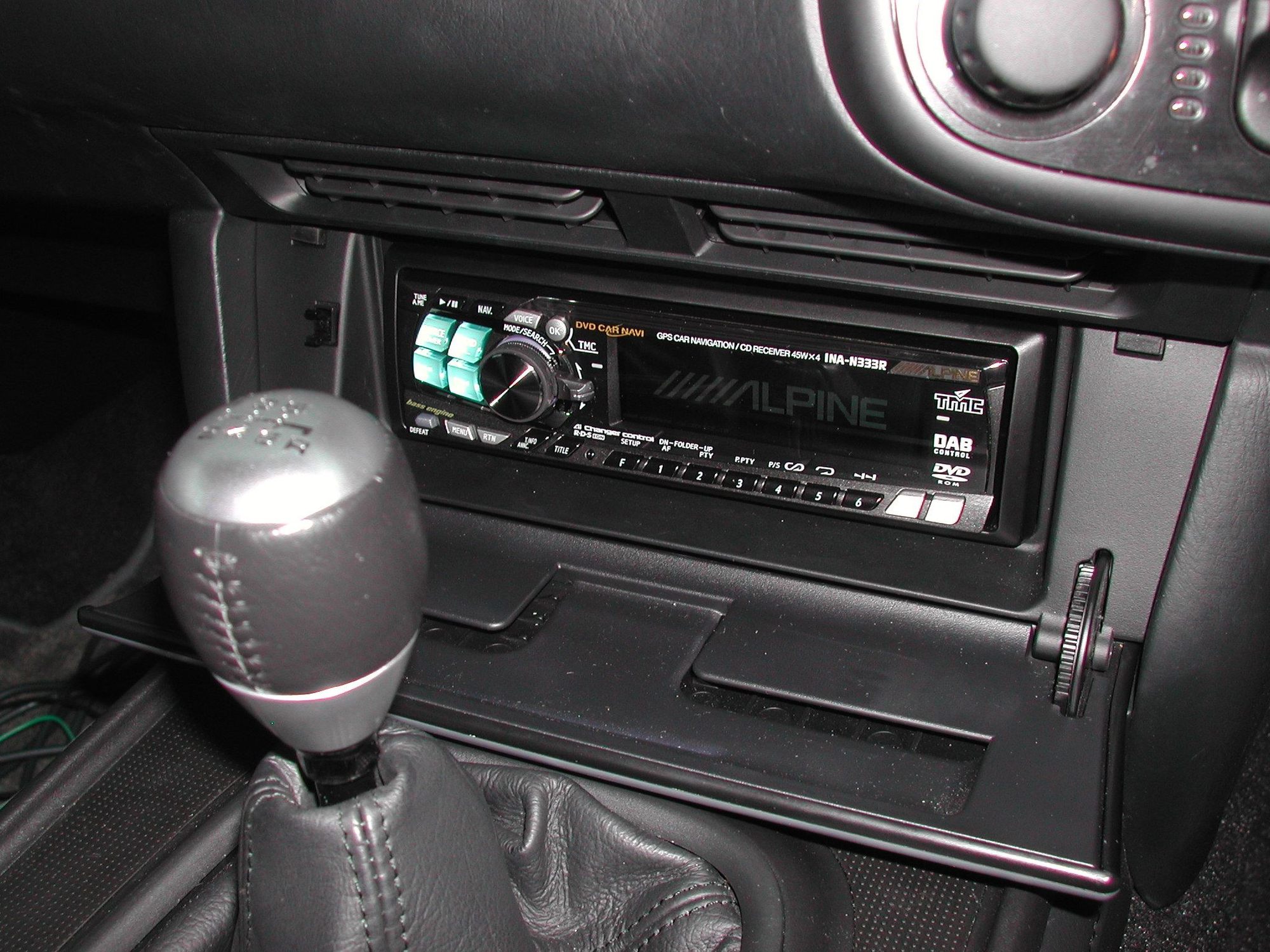

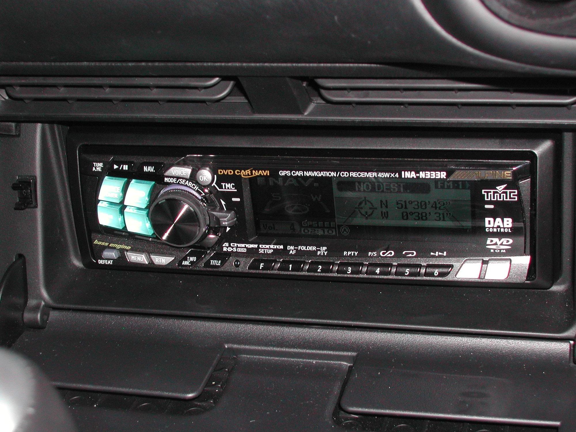

Installed by Alpine INA-N333R Sat Nav yesterday, all in all took about an hour, but would of been almost impossible without this site for reference!
Only two wires particular to the sat nav, speed pulse which is connected to the car's VSS wire under dash, and handbrake wire just connected to earth under dash
If anyone's interested in pics of these I can do them.
After reading about 7 warnings of being carefull pulling out the piece of trim under the passenger dash, I managed it breaking the tabs in the process luckily it's a 20 second walk to the stealer to order another!
Only thing left is to mount the autochanger under the seat and to decide where I'm going to put the GPS Ariel...

Slightly off-topic but your picture reminded me to ask:
What is the funny thing on the inside of the radio cover for?
MaKS
Old Jun 3, 2004 | 02:24 AM
mdjohnso's Avatar
Joined: Nov 2003
Posts: 1,627
From: Warwickshire
you mean the holder thing?
I guess it holds a Japanese driving licence or something....
Old Jun 3, 2004 | 02:27 AM
MaKSiNG's Avatar
Joined: Apr 2004
Posts: 191
From: Hertfordshire
I always thought it was for a very flat pair of Japanese sunglasses.

Does it talk , you cant look at it as you wont see where you are going
Old Jun 3, 2004 | 02:50 AM
mdjohnso's Avatar
Joined: Nov 2003
Posts: 1,627
From: Warwickshire
It talks
Volume also increases with speed as it checks the speed pulse
the screen does come out an inch and has three tilt positions too
