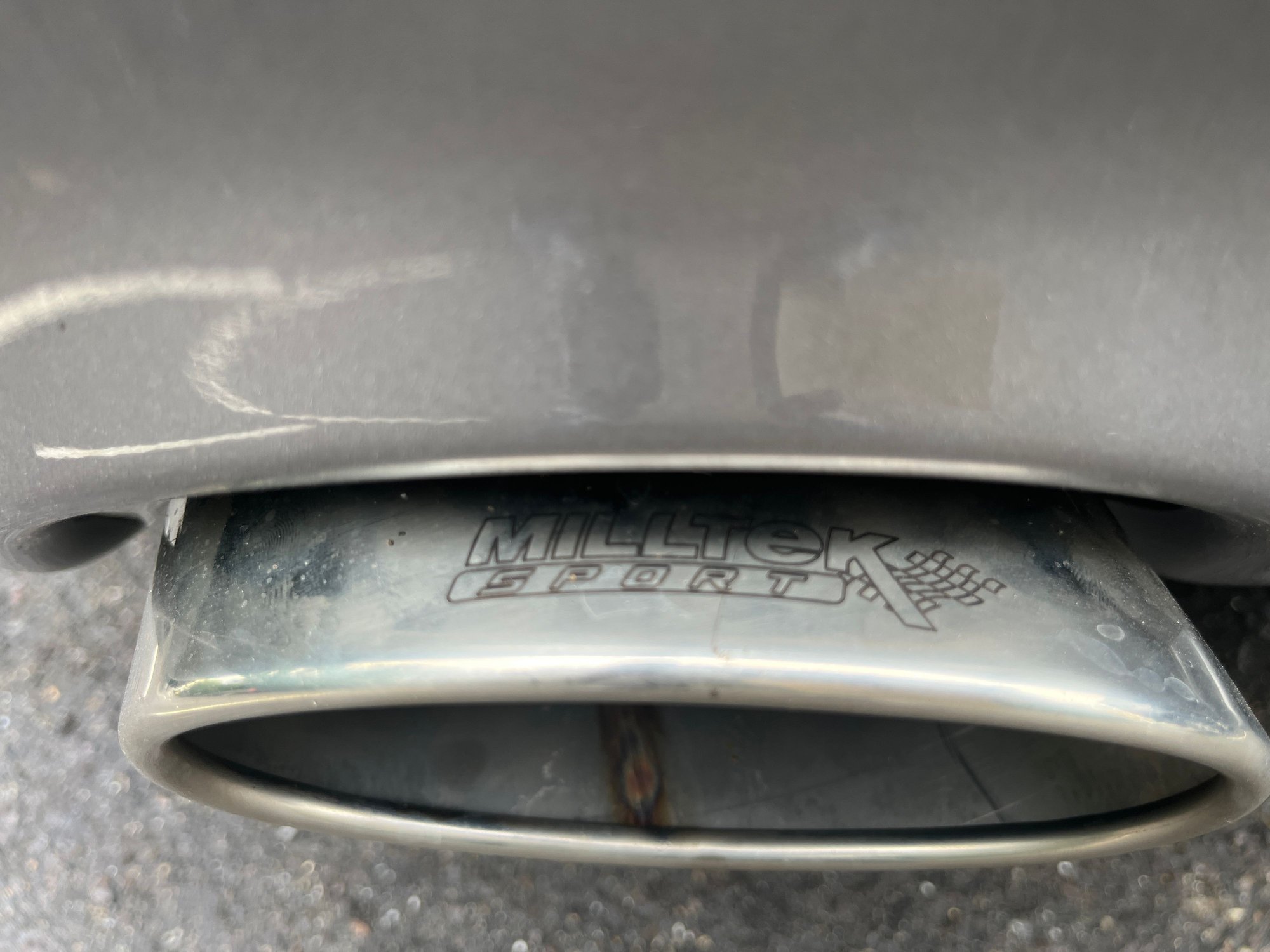

Had this fitted and first impressions are good, the exhaust looks nearly like the original. I think the exits are larger diameter, but not overly so, the tips do not protude as much as the OEM tips. The exhaust is louder than stock, especially at low RPM where it has a nice rumble, there's a bit of boominess around 2000rpm, but as the revs rise this quickly disappears. It's not hideously loud however, and I do have the OEM cat still so no power gains or any change to driveability. I will not fit a sports cat, as that would make the car too loud for my tastes.
Bunch of pics here: S2kMiltek
Overall, this is a pretty good replacement for the OEM system, that looks very similar and is not a grotesquely loud monstrosity, but suits the ethos of a small, relatively low-powered roadster.
