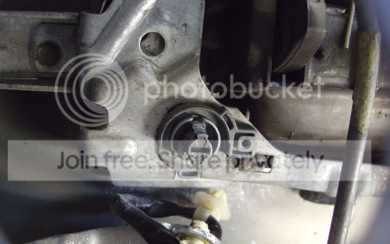

1. I cant figure out how to swap out the lock barrel. Some notes:
I've followed the manual 20-5 (picture is sh1t)
i've searched on the forum. Everyone talks about the c-clip but i can find the blasted thing.
does anyone have any photos of the position of this mysterious c-clip?

unclefester - thank you. That is the badboy. I tried to look up the exploded diagram on lings but couldn't find it. Main issue is you can't see it once you take the necessary parts out.
See here:
you need to do something similar to this:
[media]http://www.youtube.com/watch?v=Tn9S3nlZI08[/media]
if it is orientated like that exploded diagram I'll try root around with a screwdriver/pliers and see if it will ping out....
