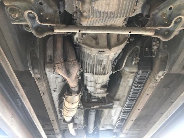

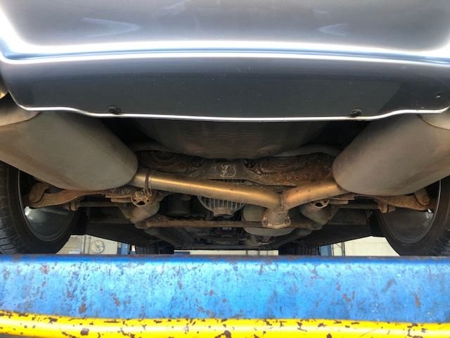

But underneath i dont really know what im looking for if im honest. They sent a bunch across and it all looks pretty solid to me , except for some rust on what looks a rear crossmember or possibly subframe ? Is this a concern or pretty normal?

I'm no expert but looks pretty solid to me! They're all a few years old now so I would suggest all UK cars wont look completely mint everywhere. Mine looked way worse when i got it treated underneath. I'm sure someone more knowledgeable will chip in soon with a more informed opinion!
Have you received pictures of the underside of the rear arches, or is there any evidence of bubbling on the outside? It's a known weak spot for corrosion.

I thought it looked pretty solid also, was actually surprised how rust free it appears for such an age of car, it was just that bit at the back which raised an eyebrow.
I havnt got pics of underside of rear arches, ill get them to take some. Im taking it is the forward side of the arches where it goes down to the floow sort of area ? definately no bubling from the exterior

In garage speak “they all do that Sir” looks as good as any I’ve seen that have not been retro treated, mine lives in a garage and when it’s up on a lift I just do the things I need without worrying too much about other things.

looks good to me. Mine was 10x worse for rust underneath - was my daily driver for 10 years in Scotland...

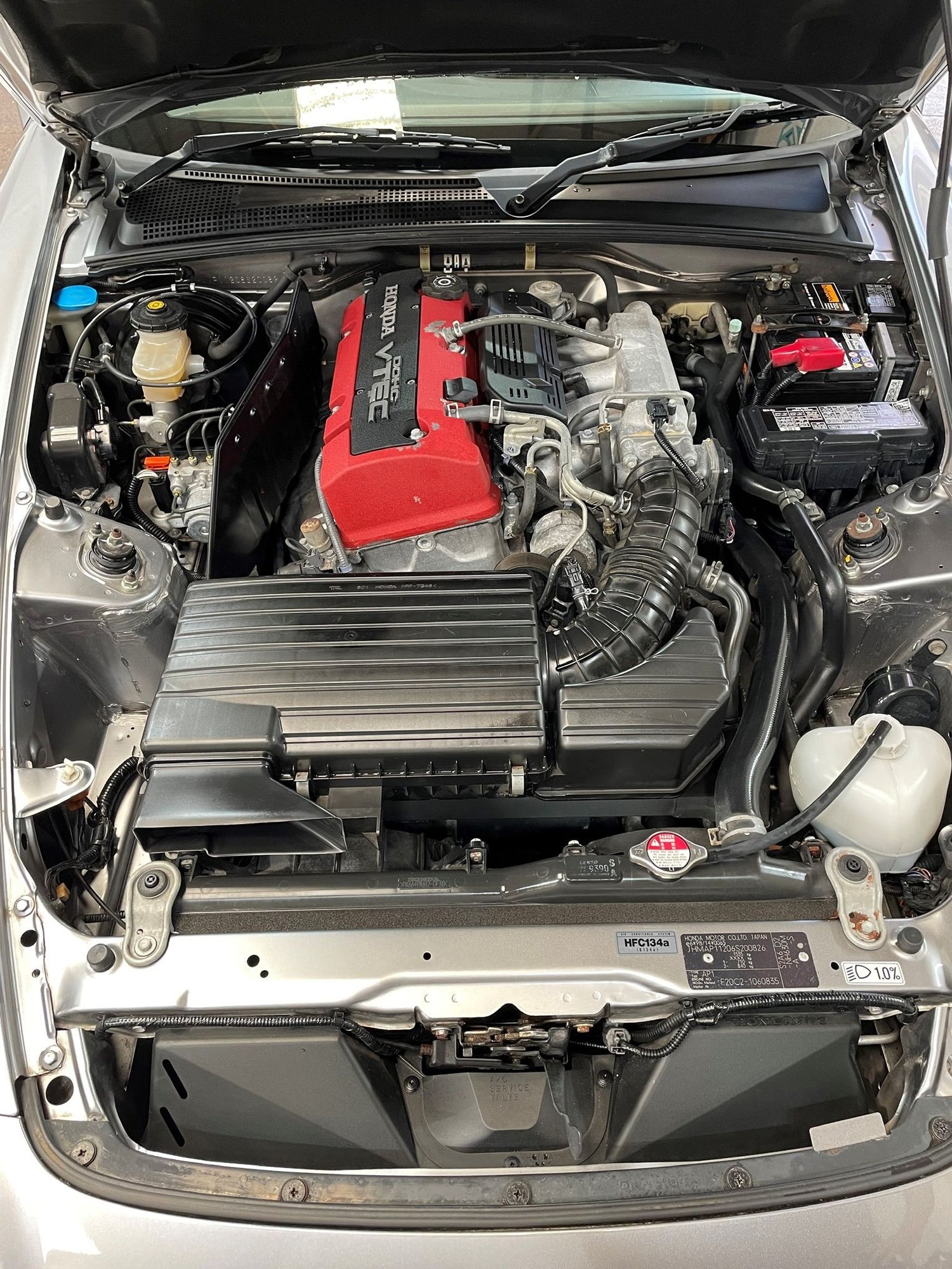

Face Lift series (2004 and later)? UK cars are notorious for rust around the rear wheel arches.
Under hood/bonnet photos will reveal how insidious the rust may be. A few bolts and covers are rust magnets in salt air.
-- Chuck
rear arches have come back clear , under hood looks solid as well

No excessive rust in the engine compartment I can see. VTEC solenoid, battery bracket, front suspension bolts, and radiator supports rust on seaside cars here in the US very easily and much more than the dusting these seem to have. There are aftermarket and OEM parts which clean up everything other than maybe the suspension bolts.
