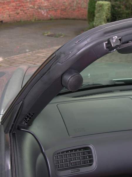

Any chance of a picture of your Tweeter positioning Mikey

Ade
The internal amp will not drive the speakers hard enough to get the best sound quality. THough you could go for a decent set of speakers that will take an amp at a later date. My front Boston's were installed like that and then amped up!
You can run a set of fronts and an "active" sub from the head unit. I'm not an advocate of active subs they - don't move enough air and are not as "tuneable" as seperates. Other problem is where to put it I tried one under the passenger seat - it was $hite! IIRC Jamie has one rattling around in the tool well
Decent music @ decent speeds = component fronts with A post tweeters & amp
A couple of pics for you! Have a look in my Stereo Stuff gallery for loads more
