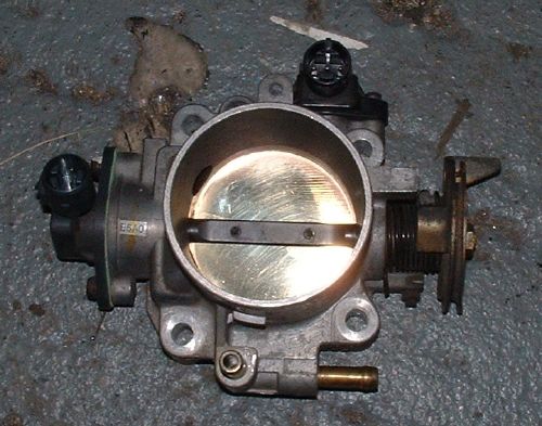

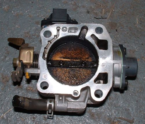

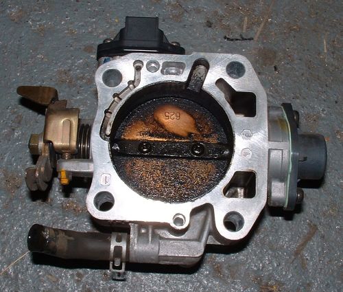

I had a look at the plugs today. All were ok with the correct gaps, except no. 4 was slightly small.
I then looked at the throttle body which was quite messy (10 years of gunge).
So I set about giving it a good clean & used the air line to make sure the passage to the MAP sensor was clear.
I also cleaned & re-oiled the K&N.
I started it up & it wasn't misfiring so much, but I really need to take it on a run to assess it properly. I may have a go at cleaning the injectors as well, if it's not too difficult.

Nice pics, you didnt have to take the TB off
Good job, did you spray towards the back of the intake manifold? - that will get caked up too.
I clean mine about once a year.
