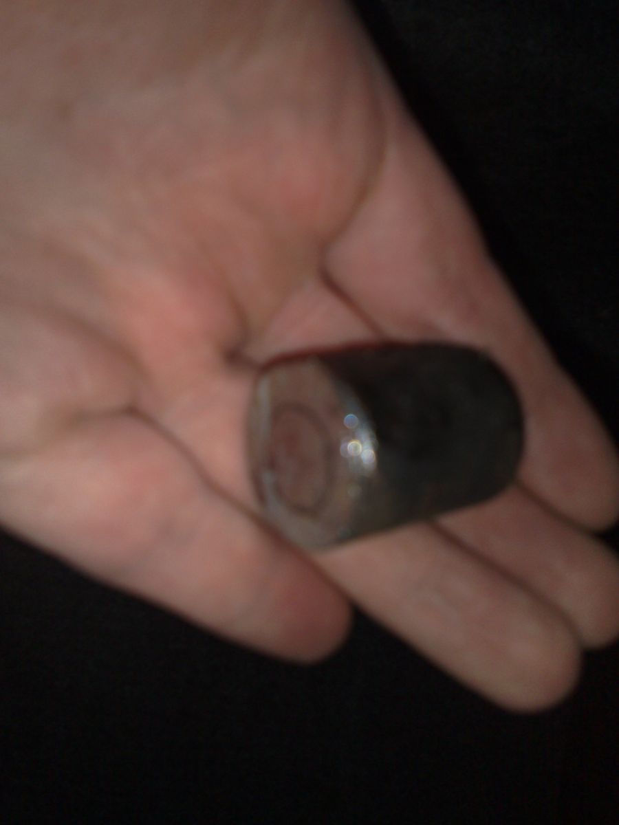

So Ive decided to fit everything at once, and made an early start on wednesday. Well 1st thing was to take apart all the rear suspension ready to fit the new powerflex polybushes.
I soaked every bolt with WD40 and allowed to soak for an hour, then got to work. We removed the rear hubs and started to remove all the rear arms.
It was a pain, most bolts eventually came out, but both rear toe arm bolts were seized to the bushes and 1 lower arm bolt seized, which meant cutting the bolts out.
12 hours later, all the rear suspension is off, and weve made a start on removing the old bushes from the donated arms, which is so far 7, as its a very slow process
