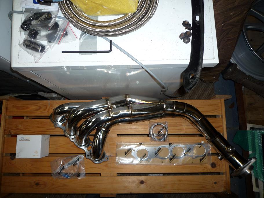

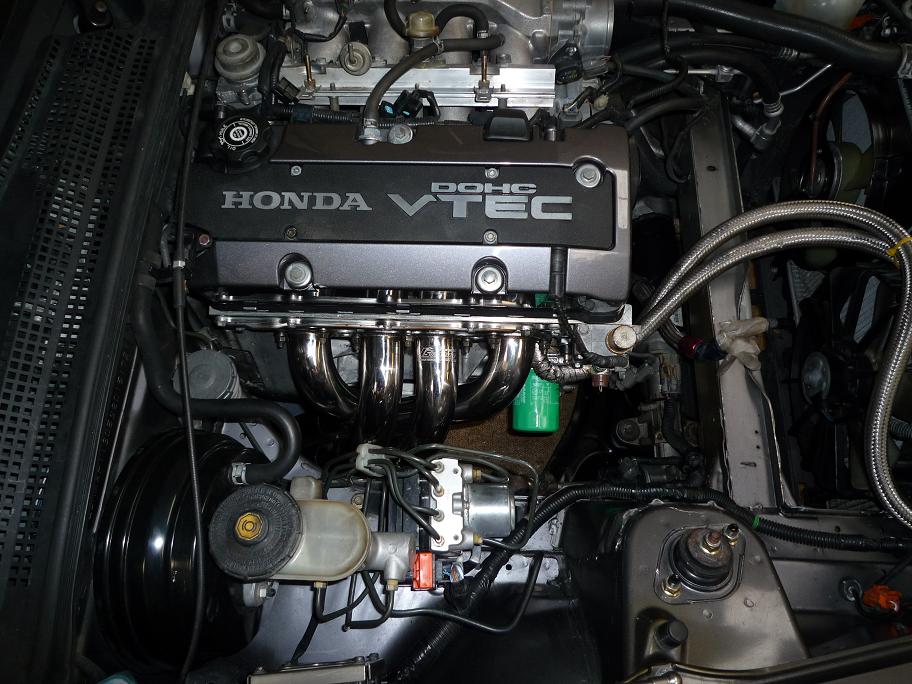

Right.... i've spent the morning under the car and above it, as I got a delivery of some bits. J's manifold (J's powermaker as I like to call it
) the only one to have imo
I jacked the drivers side engine mount up a little bit, and it slipped over the studs nice and easily.
Also bought a J's filter stopper, as I CBA to make my own
I've left the 3" decat on, and will be getting something nice to replace the 3" Asura I have on.
So that's the whole turbo kit removed now, apart from the oil pan... Just got to fit the OEM injectors now, and a temporary filter so I can drive it to my local place so they can do a sump swap for me. I CBA to do that under axle stands either
