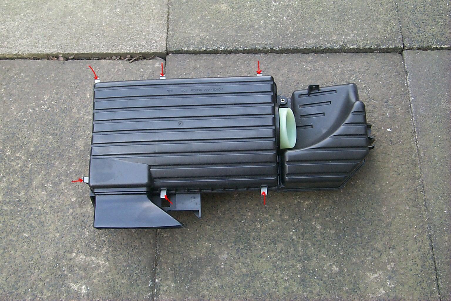

In another thread I mentioned that you can mod your standard airbox to give more induction noise. And I promised some pics... so here are some pics and a description of some simple stuff you can do to get more noise from your airbox.
Here's a standard airbox. (I'm running a Mugen CAI, so this is my airbox off the car.)
The red arrows point to the spring clips. Just undo the clips by hand, and you can lift the airbox lid off.
