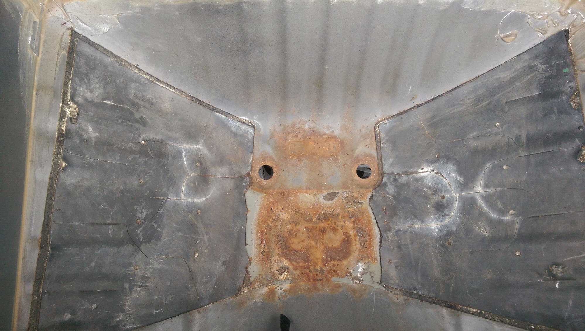

However, recent posts on this forum regarding rusty boots made me worried, so thought I'd pull the carpet up and have a look..... I was greeted to this sight:
Not the worst, turned out to be surface rust, always good to catch it early though!! Removed the sound deadening, removed the rust, treated with Kurust and applied a few layers of Hammerite under body seal with added Waxoyl.
The next problem was... where was the water coming from . After keeping an eye on it over some heavy downpours, and searching through this forum, the water seemed to be coming through the vent behind the rear bumper.
