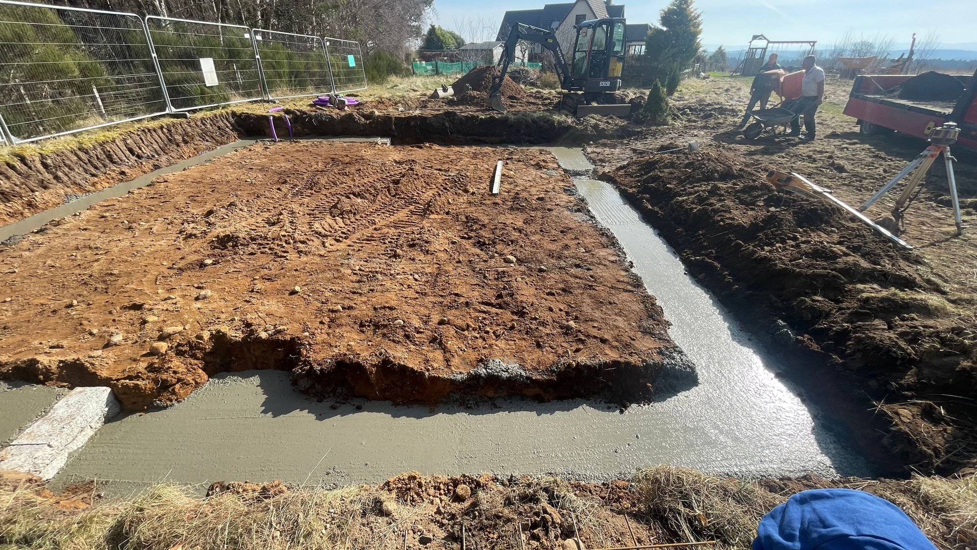

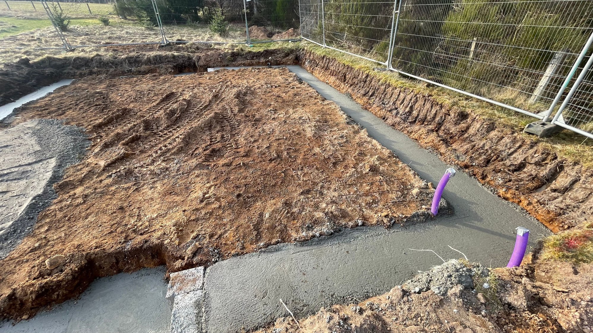

Building a new double garage for my s2k. The main use is for general maintenance on our cars and a planned refurb of the s2k underside in the coming years. Hence I’ll be installing a 2 post lift!
We started foundations this week. Great weather for it!
I’ll keep posting pics as it progresses.

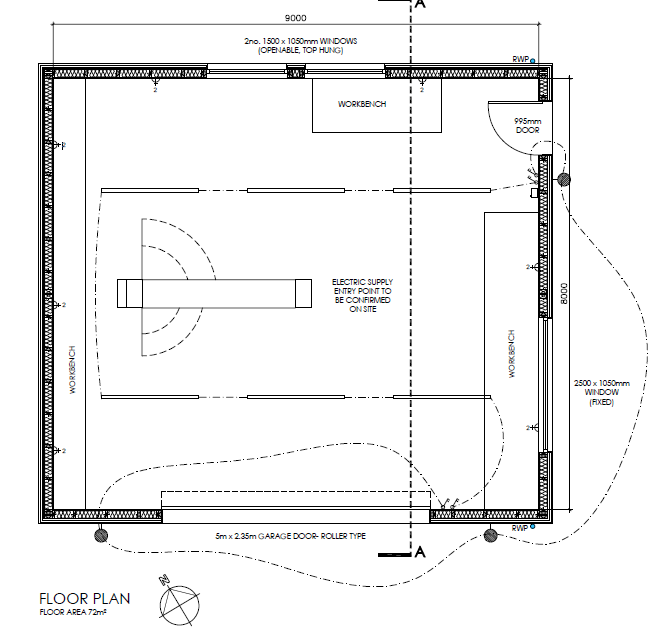

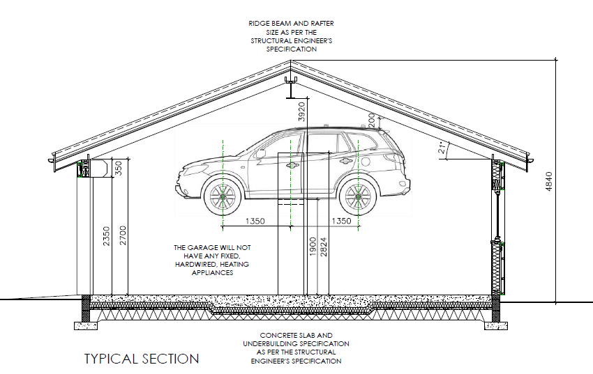

Plans
Plans
Sized for my largest car. Planning a two post lift

Do you have to install strengthened concrete for that kind of lift? I was at a place the other day and their lifts were built into the floor. Very cool, no ramp at all

It just a square area of slightly deeper concrete- 200mm instead of 150 elsewhere, with rebar accross the full floor. No big deal really! the lift will be resin anchored into the concrete.

No sink ?
Old Mar 22, 2025 | 02:22 PM
mat-i-'s Avatar
Joined: Aug 2010
Posts: 276
Likes: 74
From: Scotland
Originally Posted by noodels
No sink ?
not for the building warrant (to keep things simple) but I may install one after!!
