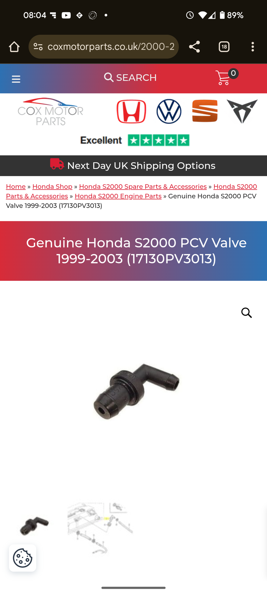

Seems the pcv valve may have had it. It was a new OEM one too. It's going back and I'll be asking for a refund.
Thd older one sounds different (the rattle when cleaned) and doesn't do the silly noise..well I'll be!

They are a plastic elbow with a perch and a spring and a metal ball. What honda charges for something someone made for them for peanuts is criminal really
Ali express special all the way, just make sure it's made so the ball can't get out lol
