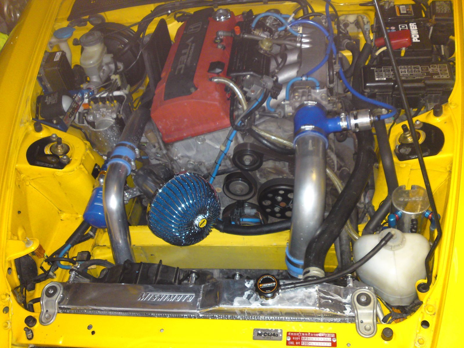

Thought Id give you all an update on my progress.
I fitted a GReddy turbo kit myself a couple months back. Ive also added a few choice items but its also still missing some vital pieces like a HP fuel pump and decat/exhaust (thanks Aaron!!)
Its nowhere near complete but so far i have done about 1000 miles in it.
I took it to a local RR a few weeks back for an hour. 70 Quid later the dyno operator commented the emanage piggyback was slow to work with and he couldnt do alot with it in an hour. Infact he didnt do anything except scratch his head and ask me questions that i didnt know the answers to!
After that it was deemed to be running a bit lean around 4k, un useably lean above 8k and a little too rich everywhere else! With the timeing 'needing work' too ! Given that I was happy she still managed to run up safely to 8k making 300hp and 220tq at 9.5 psi peak at the flywheel.
Driving the car is great fun!
Below 6k it feels immense, peak boost is there at 3krpm! Thats makes it really punchy. Above 6th it feels disappointing but still quick. I cant wait to see Lord Mase work his magic when he arrives.
Today Ive been fiddling around plumbing in an AEM ems- 1052U and its individual wideband sensor. I uploaded a map SuzukaJoe sent me for a GReddy kit. It was configured for a 3.5 bar map sensor which I do not have (but have ordered) so I reconfigured that for the factory sensor. It hardly ran, in fact I filled the street with fumes! AEM 1 - Razzy 0 !
So I reconnected the factory primary O2 and reconnected the EManage Ultimate piggy back and factory ECU!
She is now back to sleeping in the garage in front of the radiator after a nice long bath!

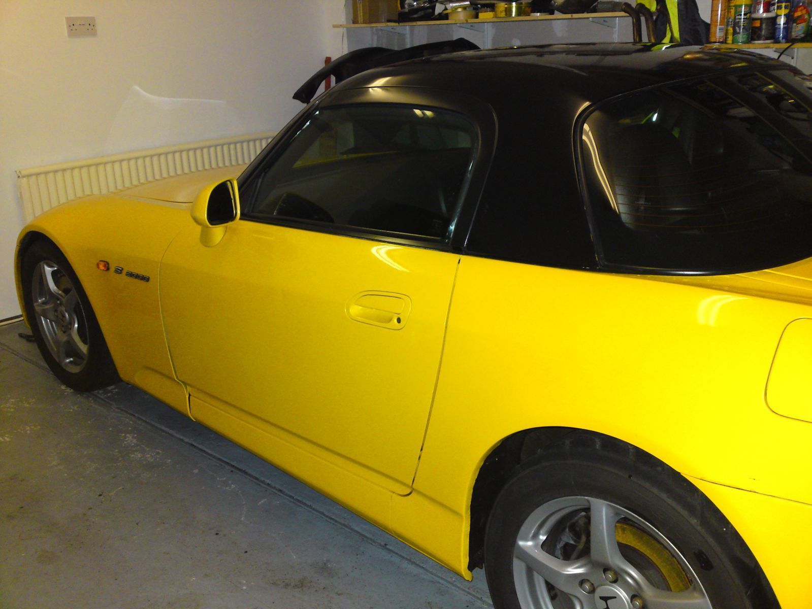

I like the look of the black HT against the yellow bodywork
It looks like the N/S sill cover is misaligned with the front wing though
