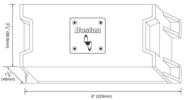

These are BIG Crossovers.
9" Length x 3 1/2" Wide x 1 7/8" Deep
The Panels a good idea. Does the panel hold OK?

On to cross overs DON'T put them under the dash you WILL get interference from all the electronics and power lines under there (I did and it's a PITA having to move them around and rewiring to try and escape it)
Me I put mine in the door card to save having to put two cables through the grommet.
You can just see mine in my 04 car in the pic below. IIRC the drivers side one I cut a matching section out of the polystrene on the back of the card.

the boston cross overs will fit under the dash, dont put them under your seats. the cable running is a great ball of joy, took ages but its well worth it.
i very much doubt you'll get the cross overs in the door cards i tried and failed so had to go under dash. logn as you dotn wrap then to calbes to much you'll not get any interference.
