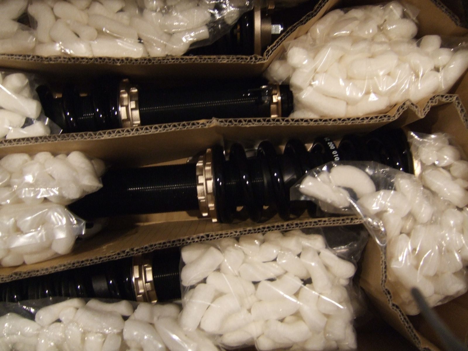

I ordered these from the Market Place here on s2ki. They looked to be good and I like the fact they have separate ride height adjustment from spring preload. And the price was VERY right. All reviews seem very positive on this lot, from the scooby and evo boys too.

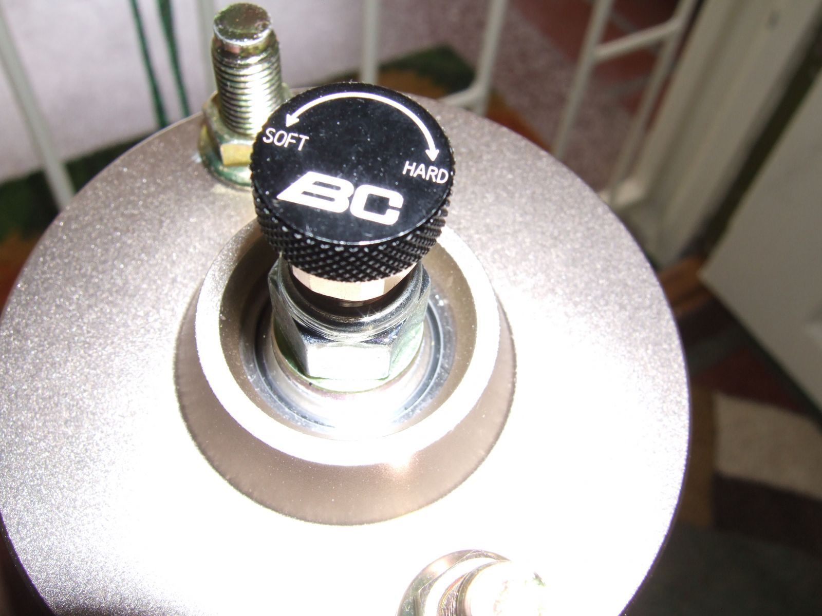

32 clicks , all I need is 3!
You can order these with anything from 10K - 14K springs since the dampers will handle +/- 2K off from 12k. I got the 12KF / 10K rear combo as similar setups from KW and Tein in the SCC suspension comparo seemed to do quite well.

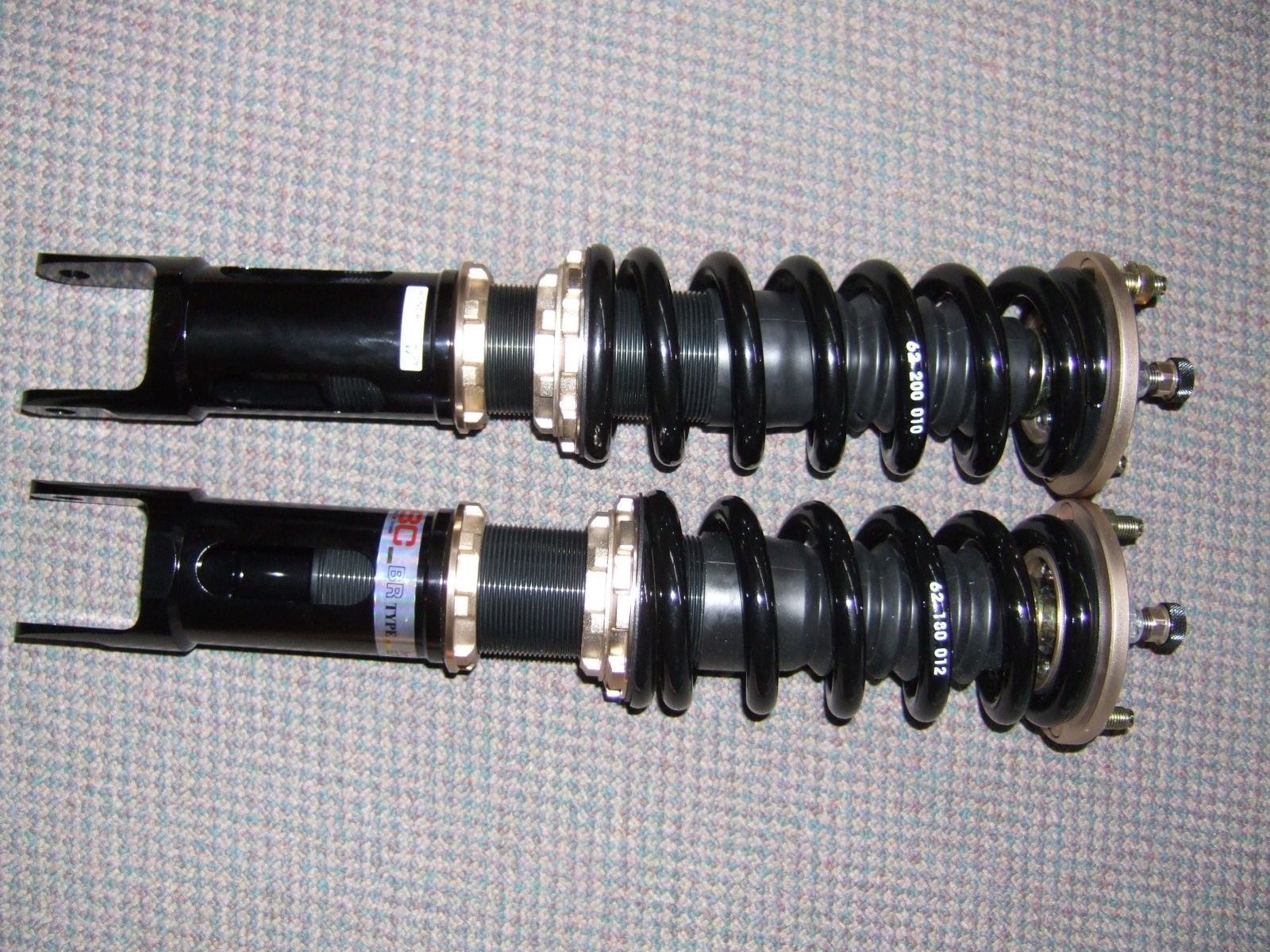

I noticed however, that the 10k were on the front and 12K on the rear. I alerted the seller to this and he said this was the 3rd case of this happening. No biggy - just swapped them around after taking note of the pre-load on the springs based on distance between top spring seat and the spring perch. At least I got to pull them apart and put them back together as an exercise.
The rear one pulled apart:
Difference in spring lengths - 12k shorter
The two rears side by side, one with correct spring (10k) and one with wrong 12k.
These will be fitted on Friday. I will let you all know how they feel. Will be corner weighting this weekend at the stock ride height or maybe 1cm lower since I have some wicked speed humps to deal with around here.

My first impression is WOW. The ride is stock or softer ! I was fully expecting a very jarring ride given the 12k/10k setup vs the stock spring rates. I have the front dampers on 15 clicks out of 32 from softest and rears 10 clicks/32.
I went banging over all the man hole covers, wash boards etc., and really, these COs are extremely livable. I am beginning to question the stated rates. Of note though, the small ripples or sharp sinks are a bit harsher than stock, but not the big ones, which seem softer. I guess at these settings that means it resists quick changes more than slow ones?
Dive on braking seems reduced though. Didn't try anything to dramatic yet, but at usual road speeds, dive is almost not there. No chance to evaluate body roll yet.
I will try some harder settings over the weekend. I think the rebound in the rear needs some more damping. A smooth low hump in the road tends to send the back flying up faster than usual, un-weighting it more than stock which means bad for if you meet something like this in a corner at speed. I reckon harder settings on the damper should fix this.
Overall impression : A+ compared to stock. The only shortcoming would be the lack of separate compression and rebound because I feel the compression is good at these settings but rebound could be a bit harder. Otherwise, my biggest fear is gone - it has not turned the car into a track only daemon. I can still take the birds out
