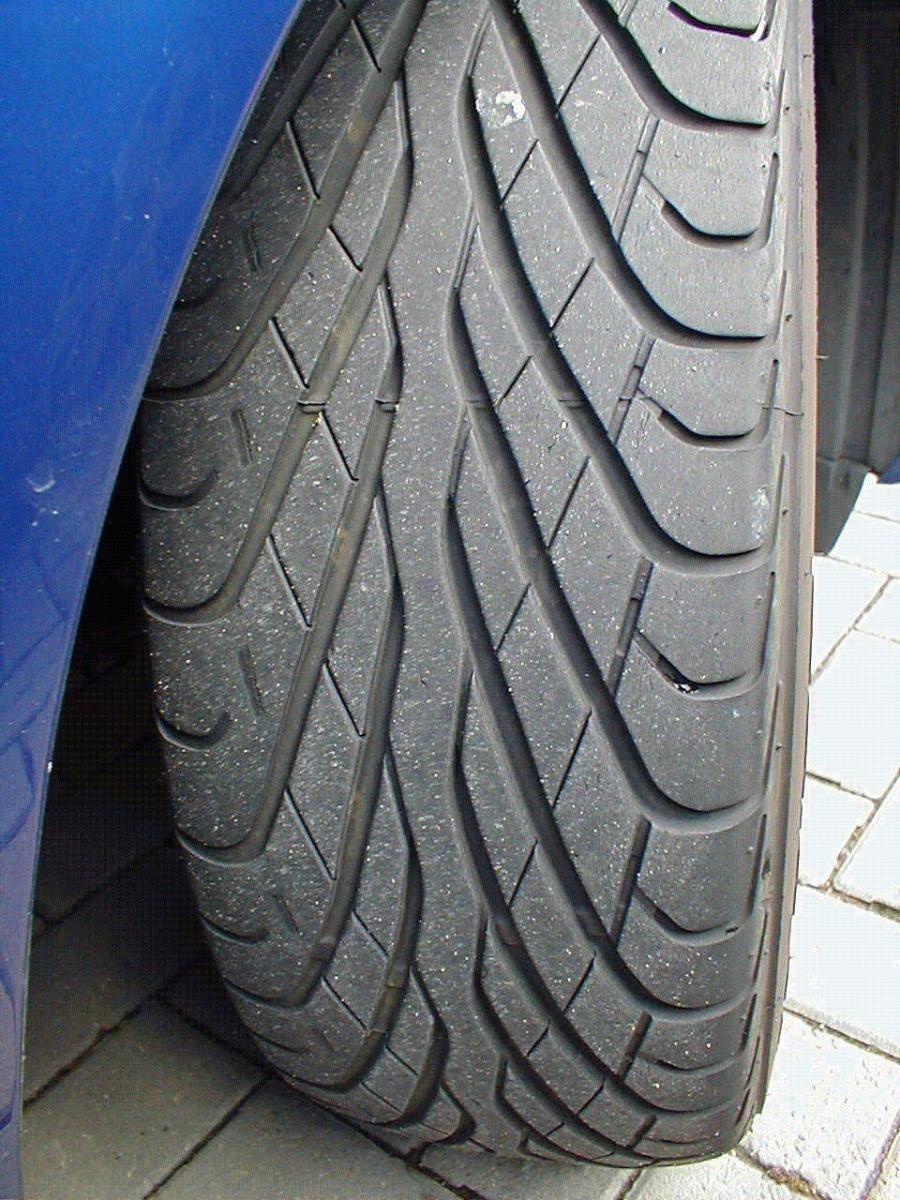

Here's my front tyres guys if it helps... with 13K on the clock.
Interestingly, the tyre place where I had my new rears fitted tried to talk me into changing these tyres as "Almost shot"
For that reason, I particularly asked Brindley Honda to check them over at the service I've just had done. They reckon that the wear showing is just about ideal and that the lowest point on the inside edges measures 3mm on each tyre.
Haven't I read somewhere BTW that the revised alignment settings are likely to result in heavier tyre wear? Obviously that wouldn't be a consideration if markcu's settings were wildly out.

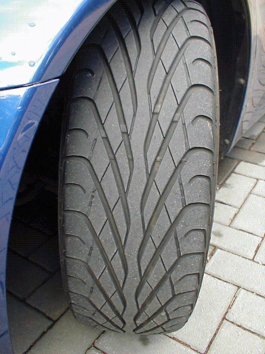

These are my tyres,
the right is worse than the left...

Wow that wear does look extreme doesn't it!!? Something wrong there if your're tyre pressures are O.K. Have you checked for transportation spacers in the suspension springs?
