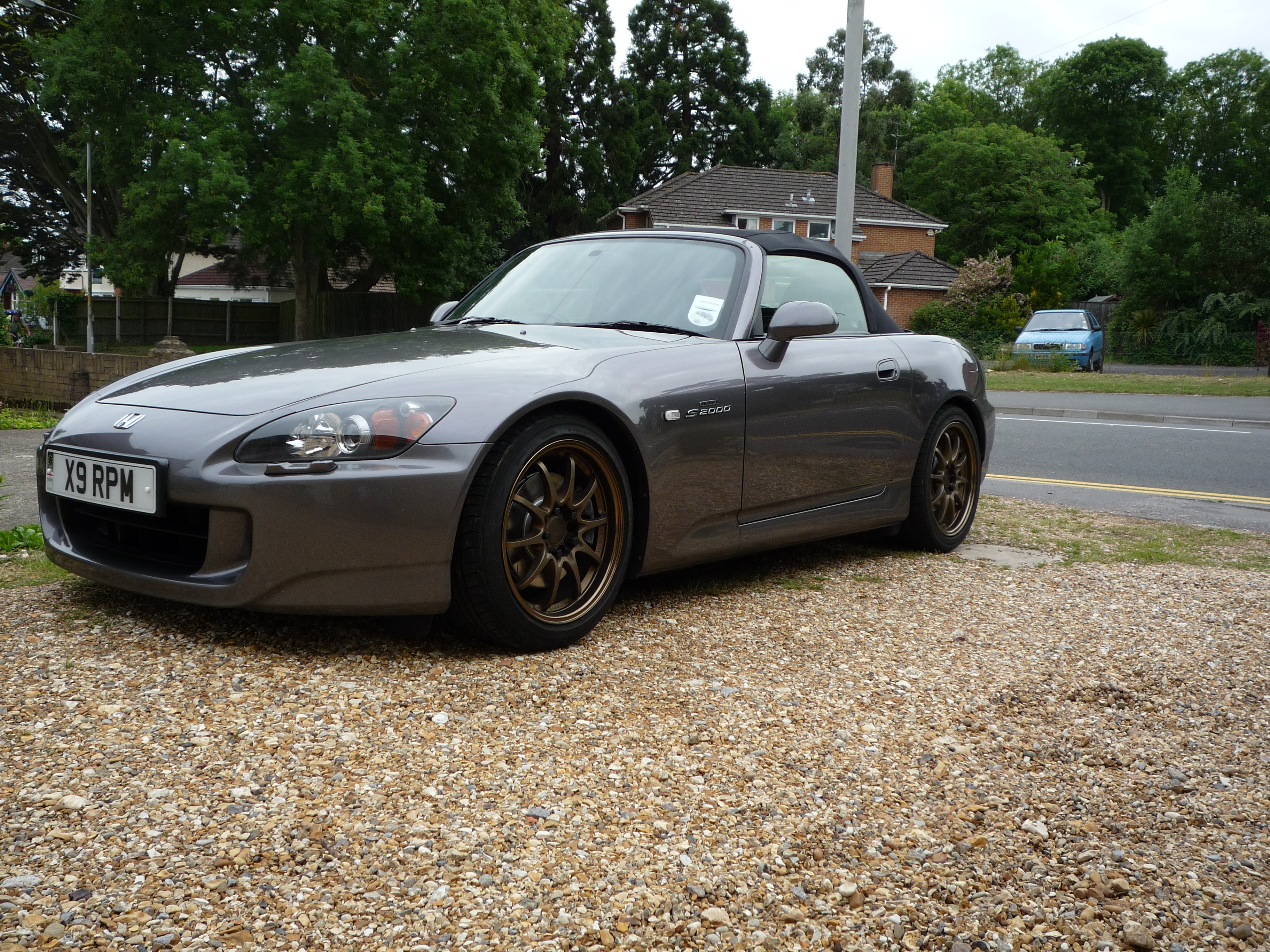

It's too subjective to say. Some people like non staggered, some people don't. Some people (odd people ) like 18"
For me the perfect spec is 17" all round - 7.5" +51 front and 8.5 or 9" rear +59....
The limits for front and rear offsets is a tricky subject, but I don't like anything sticking out and arch rolling is just alien to me. The lower the number, the more sticky out they will be.
It would probably help if you found the standard 17" offsets, then went to one of the wheel threads in the main gallery and found what you think looks ok.
This is what the above sizes look like (8.5" rear rather than 9")
