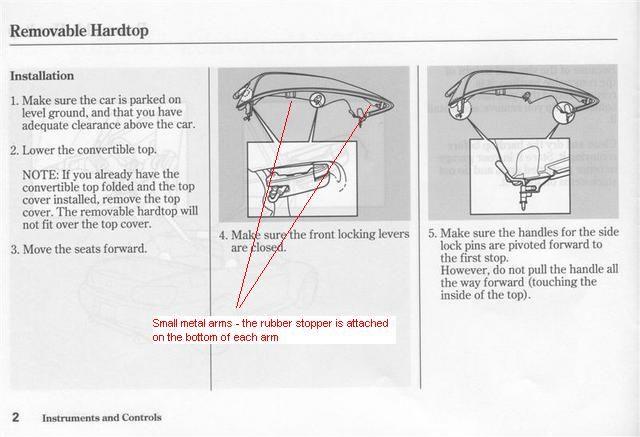

Found this nestled between the folds in the softtop after a short drive, looks like it's fallen off the mechanism somewhere, but can't see where - any ideas?

That is one of the two "feet" from your hard top. The rear of the hard top has two metal flanges and there should be a rubber foot on each. These are designed to rest against the soft top (the feet should rest on the leading edge of the soft top) and stop it rattling when you have the hard top fitted. I lost one of mine and Honda replaced it FOC.

That is from the hardtop. When you put the hardtop on - there are two prongs on each side to keep the roof folded and stop it from bouncing around - that rubber thing is attached to the bottom of each arm on the hardtop. Not a very clear description. I'll try dig up a picture for you

Thanks people, that'll do, I'll have a look at the hard top and put it back on!
