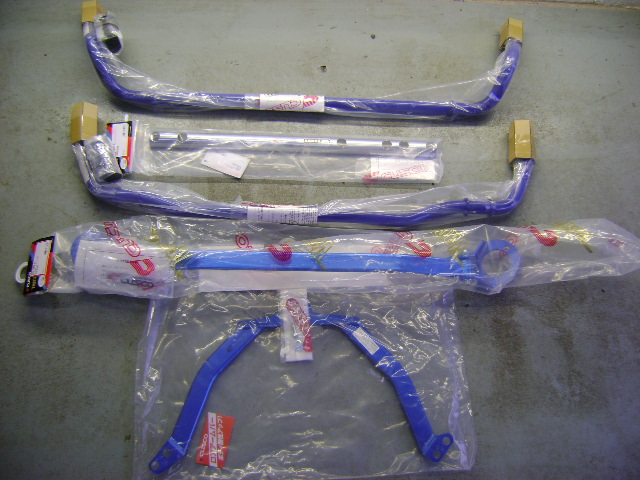

Cusco Bits

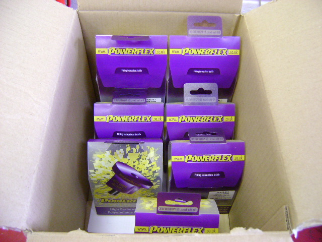

PowerFlex Bits

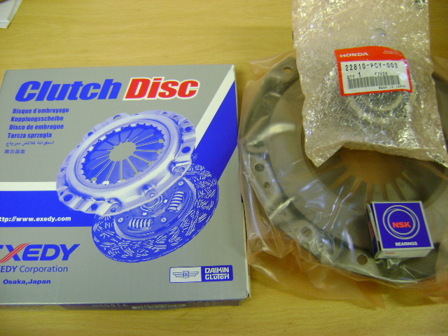

Clutch Bits

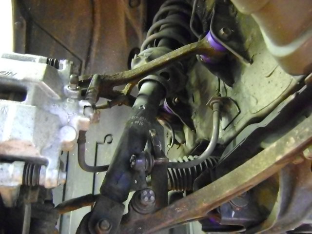

Tony then got to work and fitted the bits ! Luckily I only had siezed rear camber bushes. This was something I knew after a previous visit to Center Gravity where Chris had fitted Mugen Caster bushes and powerflex rear toe bushes.

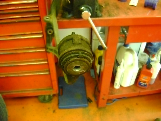

So, off came the wishbones with the old bushes

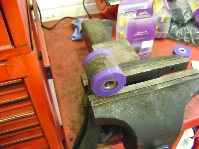

And on when the new bushes
Quick picture showing the arms back in with the bushes fitted

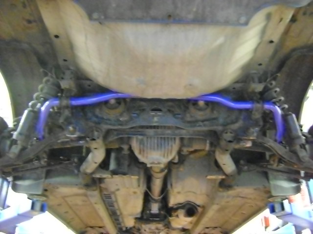

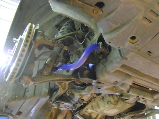

After the bushes, in went the new front and rear ARBS

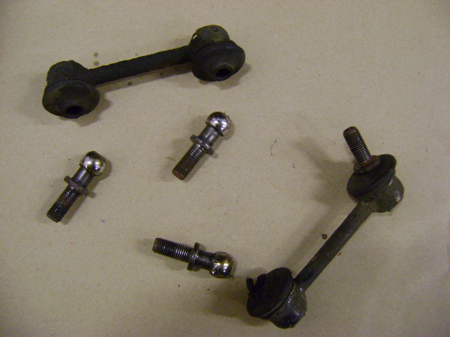

Unfortunately when removing the old rear ARBs the droplinks didnt survive.

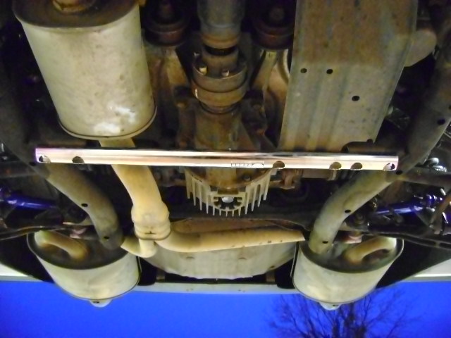

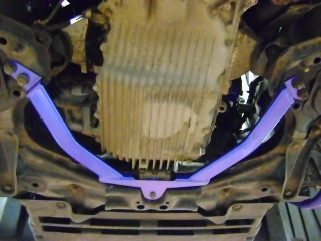

And then the front and rear lower brace bars
