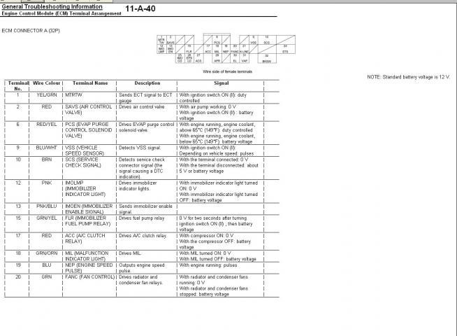

Ok, if you look on the diagram below its the connector plug with 32 wires in it. If you pull out the plug and look into the mouth of it, you want pin 9 which will be a blue and white wire. Should be on the top row.

No .... wrong wire.

still no definite answers. i'm betting on the blue/whi wire.

Did you not read my post above?
That is the one.
If you check my photo above you will see that I installed my yellow box right next to it.

thanks steven. i hear some people wiring the YB near to the ecu and it not working. Some say you have to wire it directly to the tranny. also without pictures its hard to tell what wire goes to the signal in or signal out.
