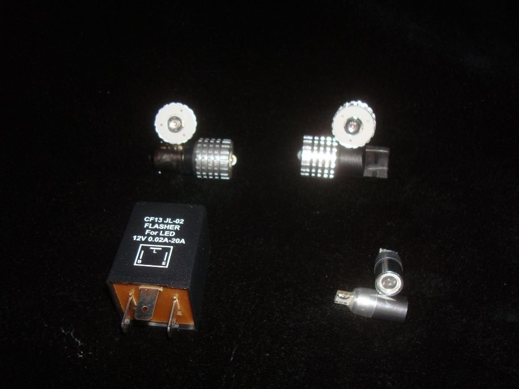

I don't know about you but I hate the orange in the taillights... so I figured I'd buy some LEDs and replace them and while I was at it the side makers and fronts too. I bought all the LEDs and flasher relay from SuperBrightLEDs.com
Note: I have CR clear side markers installed and rick's clear diffusers in front.
1156 (RED) - 7443 (ORANGE)
Flasher Relay - 168 (ORANGE)

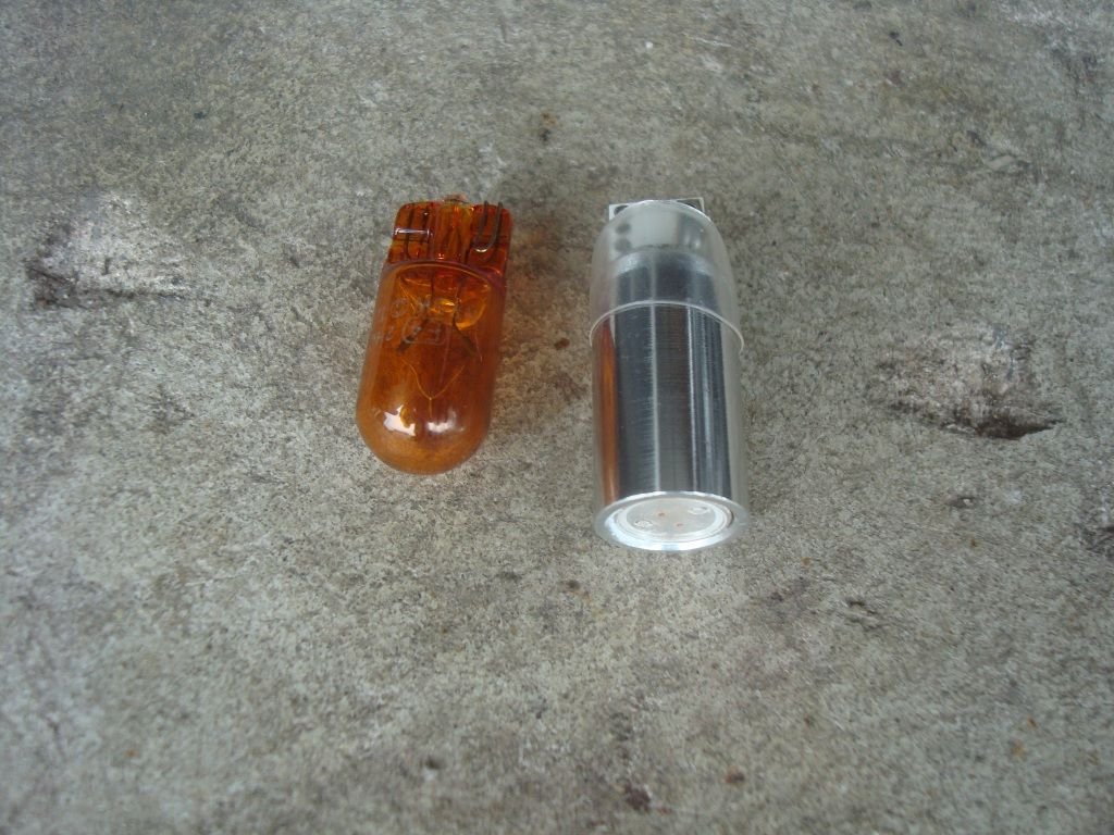

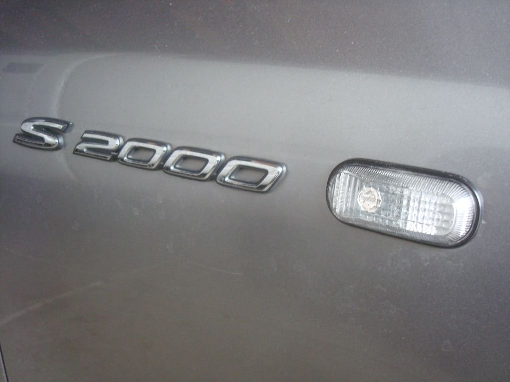

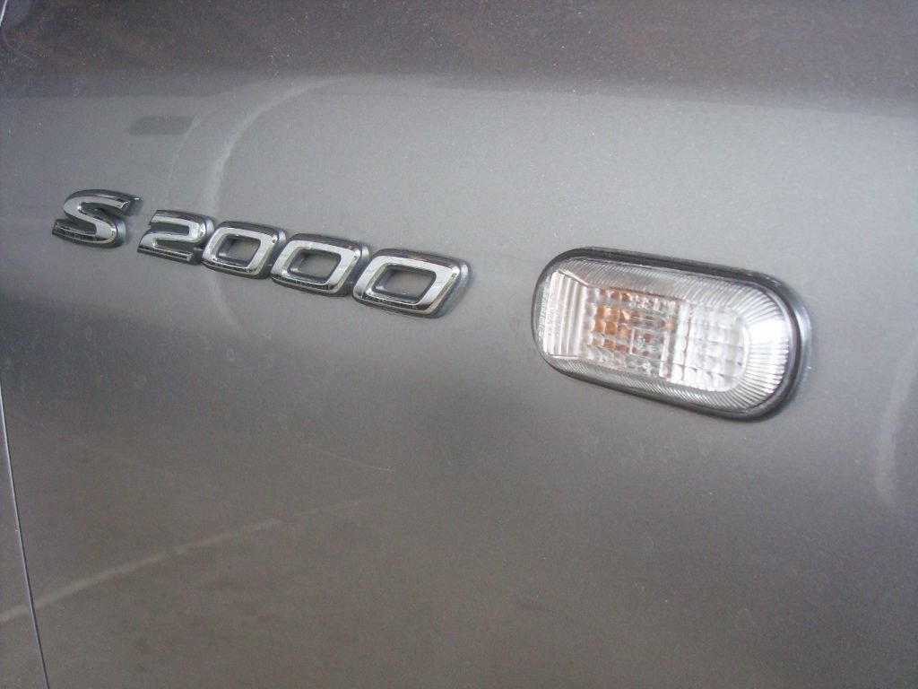

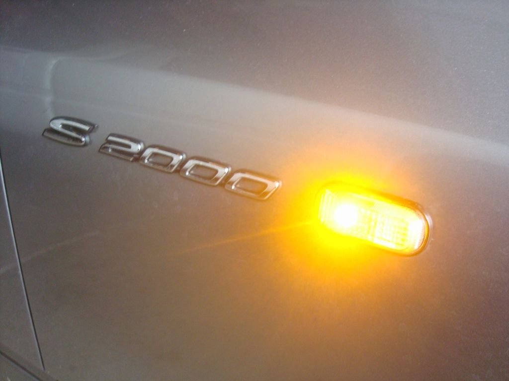

sidemarker bulb and LED (its a little longer but still fits in sidemarker)
regular bulb off
LED off

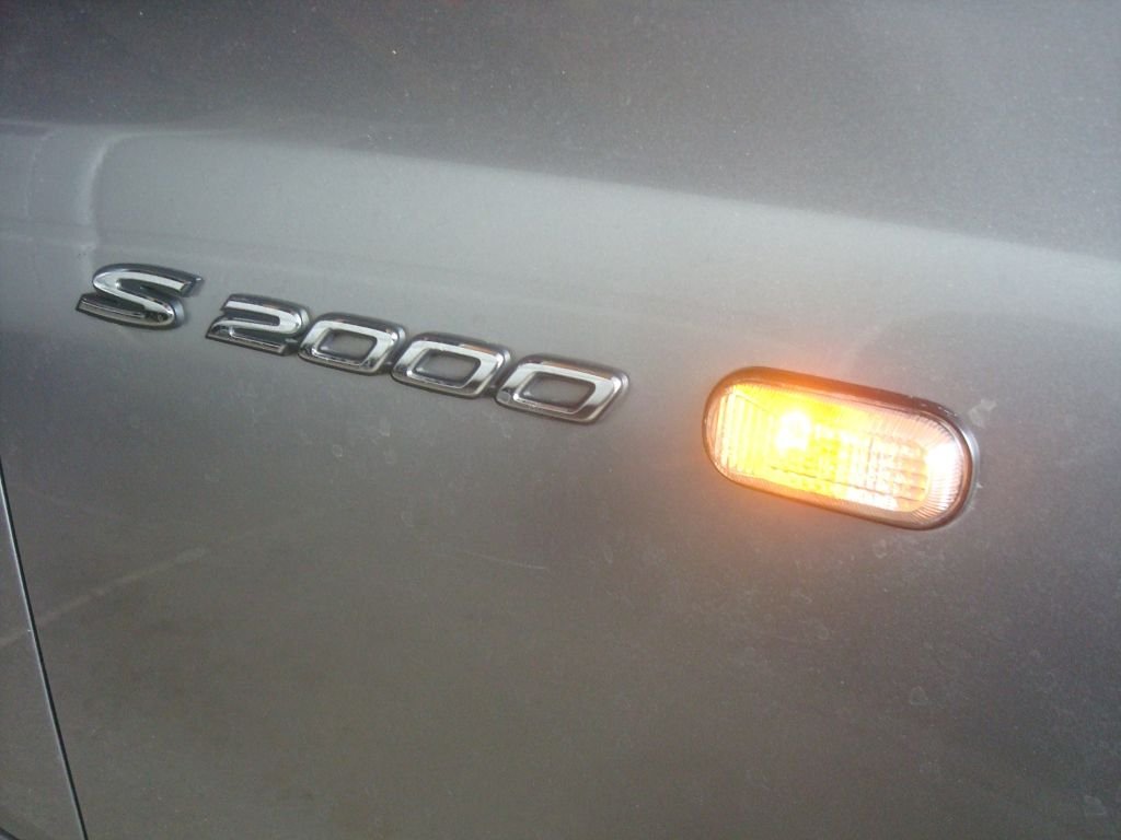

regular bulb on
LED on

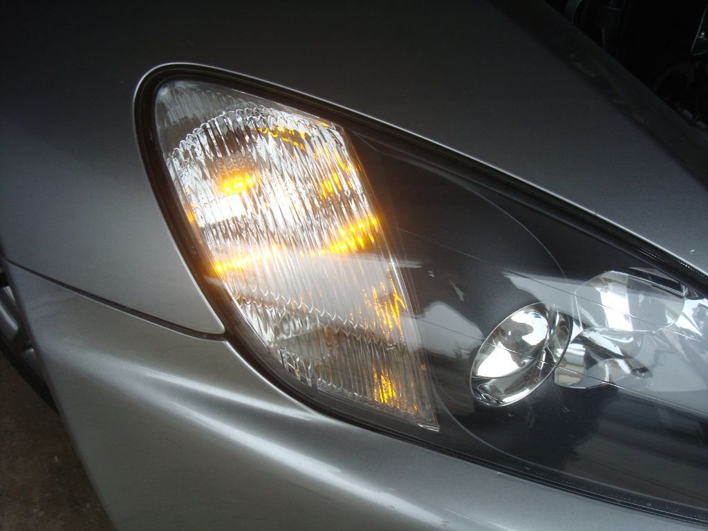

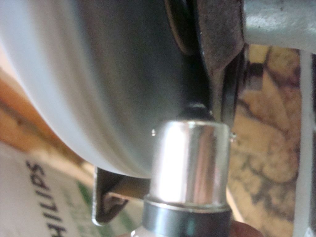

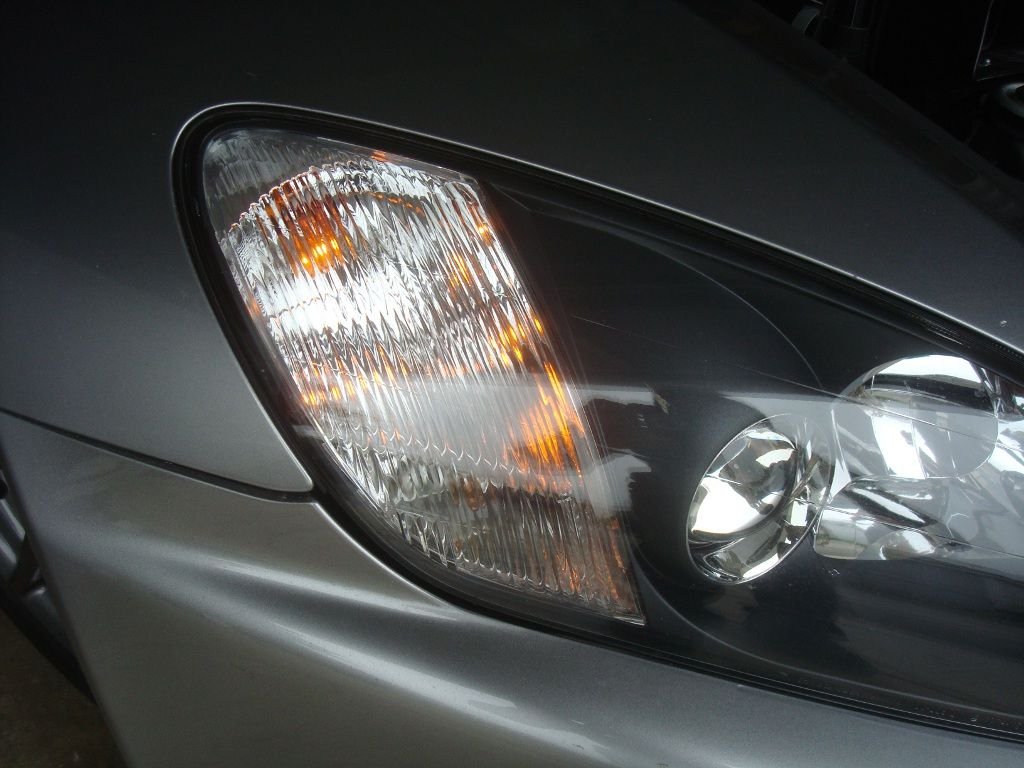

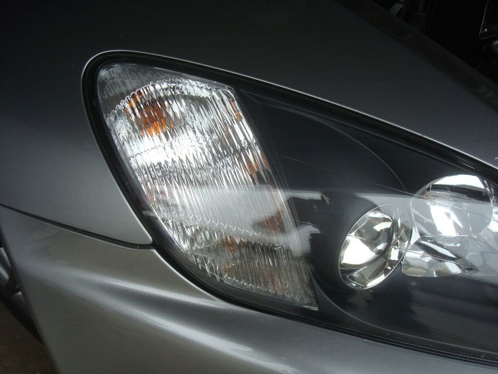

Front turn signal bulb and LED
you can get to these from inside the wheel well by taking out two plastic clips and pulling the fender lining back
regular bulb off
LED off
regular bulb on
LED on

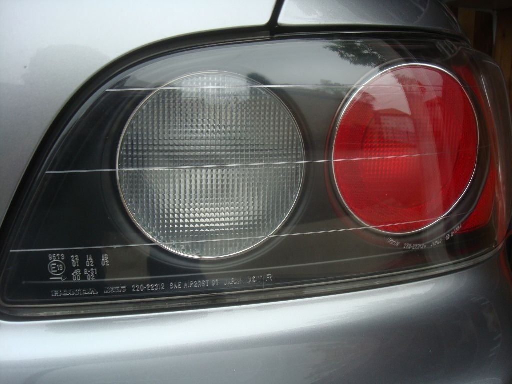

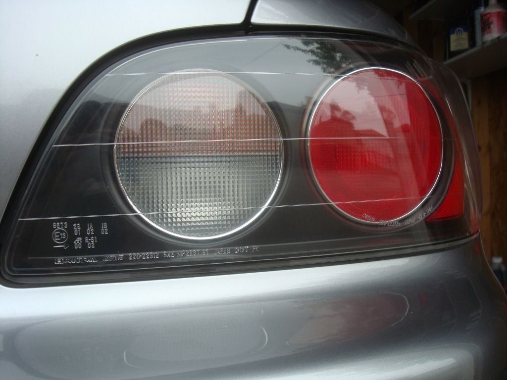

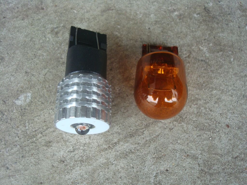

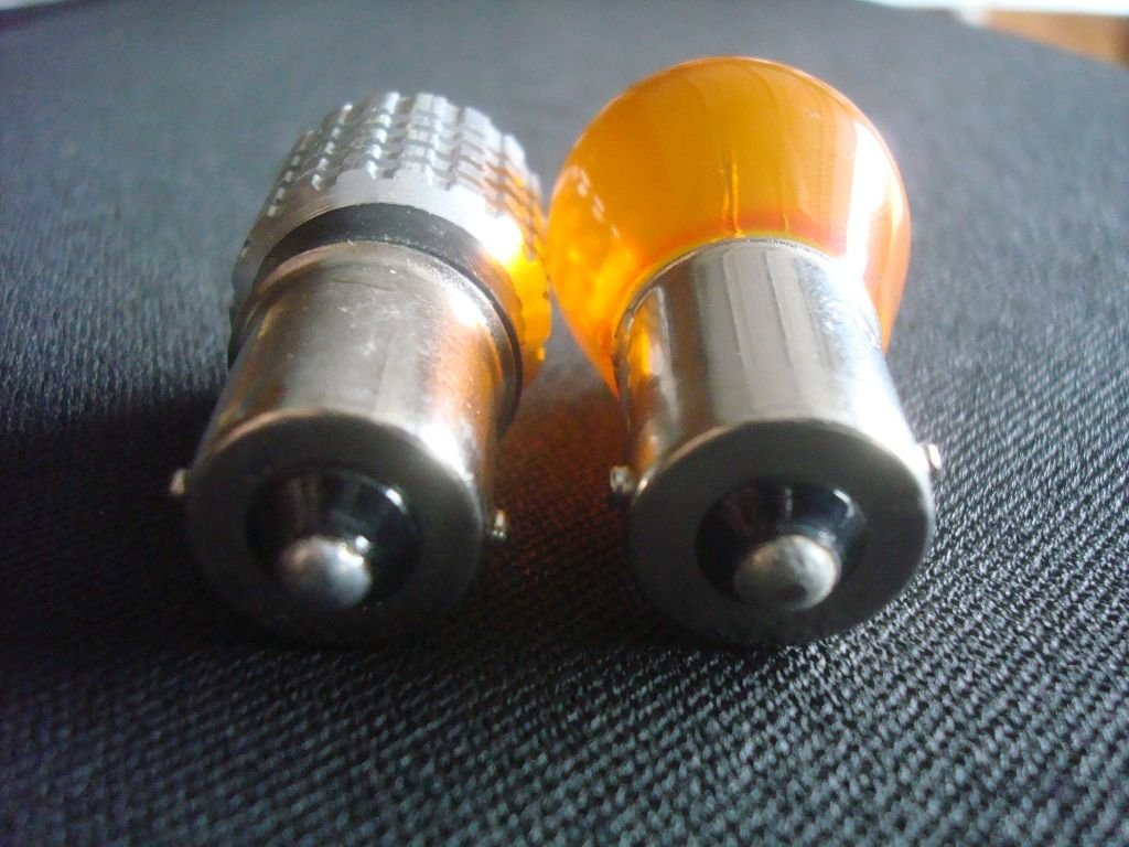

Rear turn signal bulb and LED

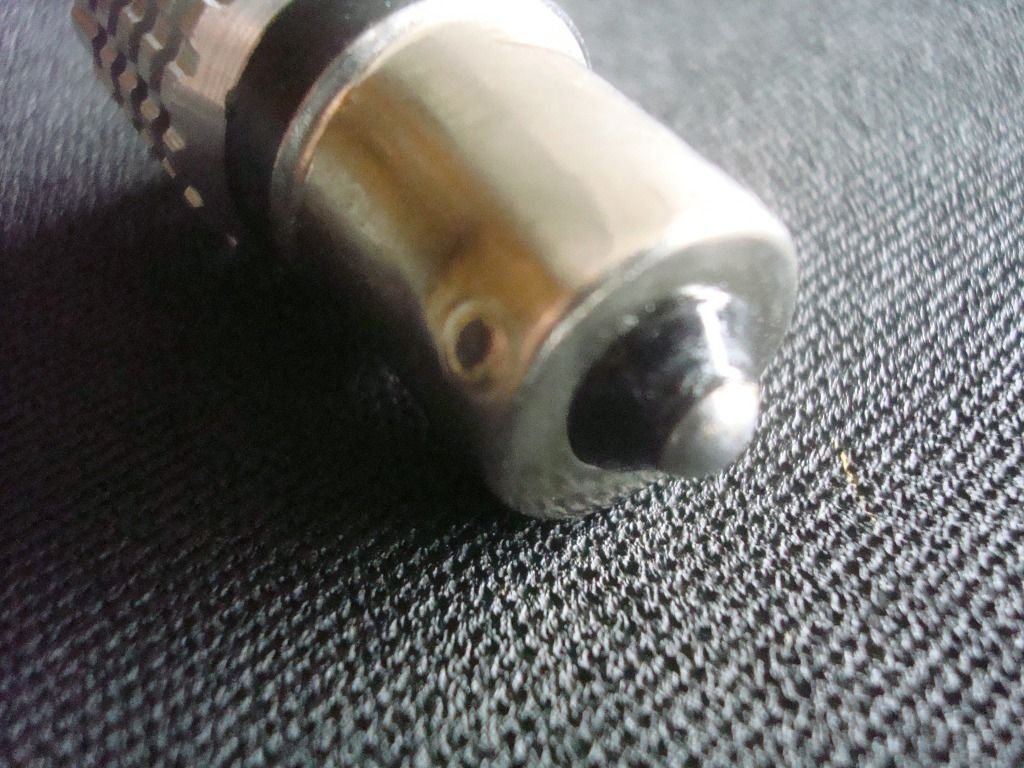

Notice that the bulb's ears are not directly across fom eachother like the LEDs. This is because its a 7507 bulb not an 1156 like all the bulb charts say.
so because they don't sell a 7507 LED I cut one ear off
the aftermath
as you can see from the socket an (unmodded) 1156 won't fit
regular bulb off
LED off
regular bulb on
LED on (the light is just as bright but more directional)

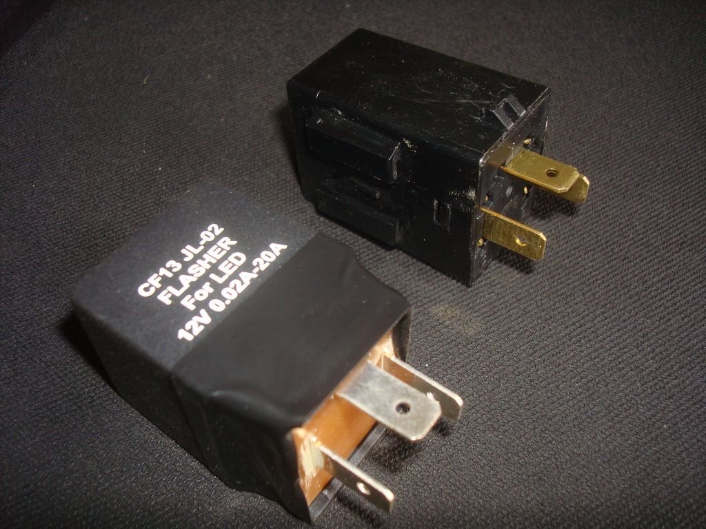

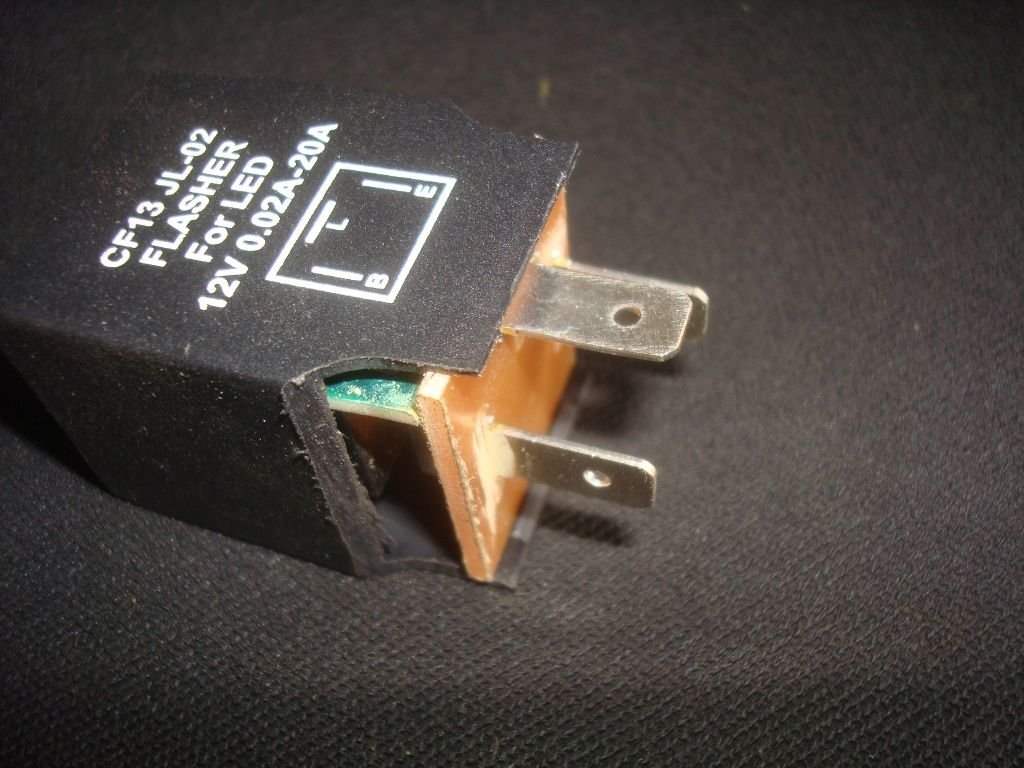

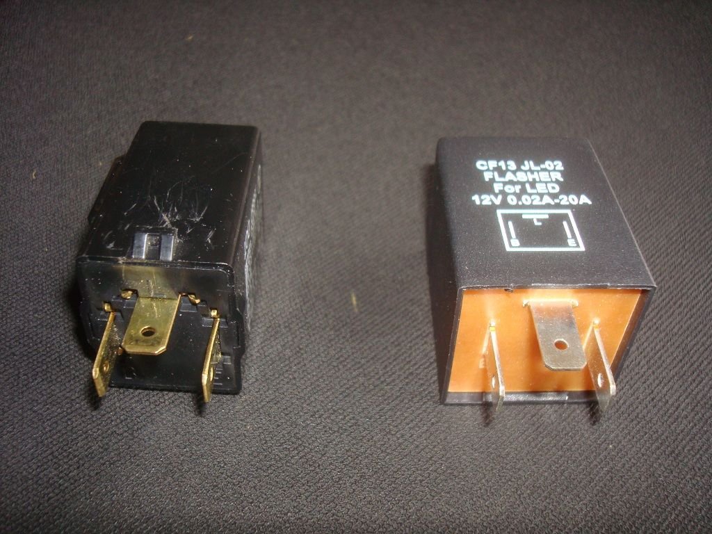

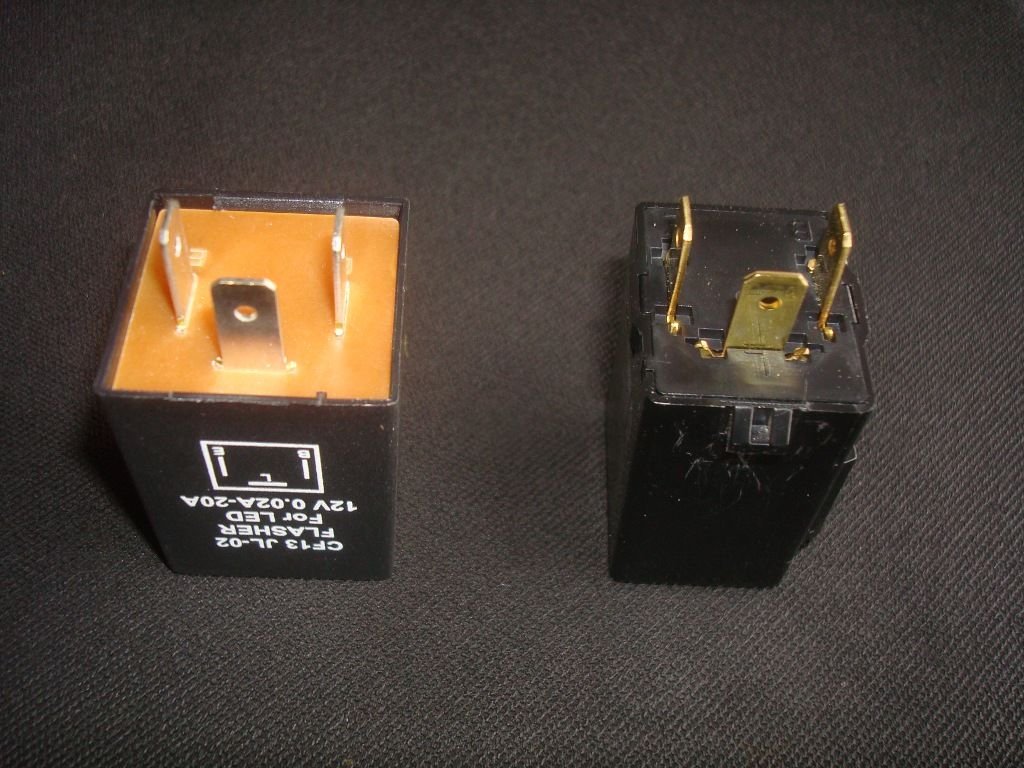

New flasher relay and OEM (If you don't change your flasher relay you'll get the hyper blink thats soooo annoying)
of course its too big to fit!
so I modded it too
and after some tape its not so bad
