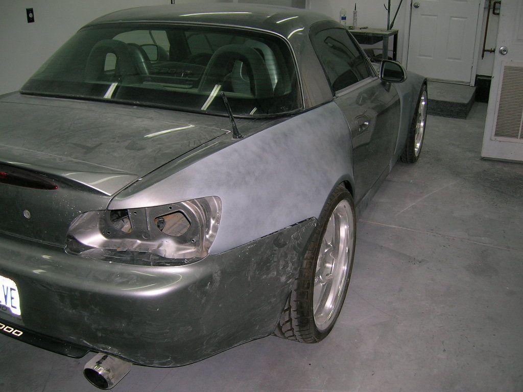

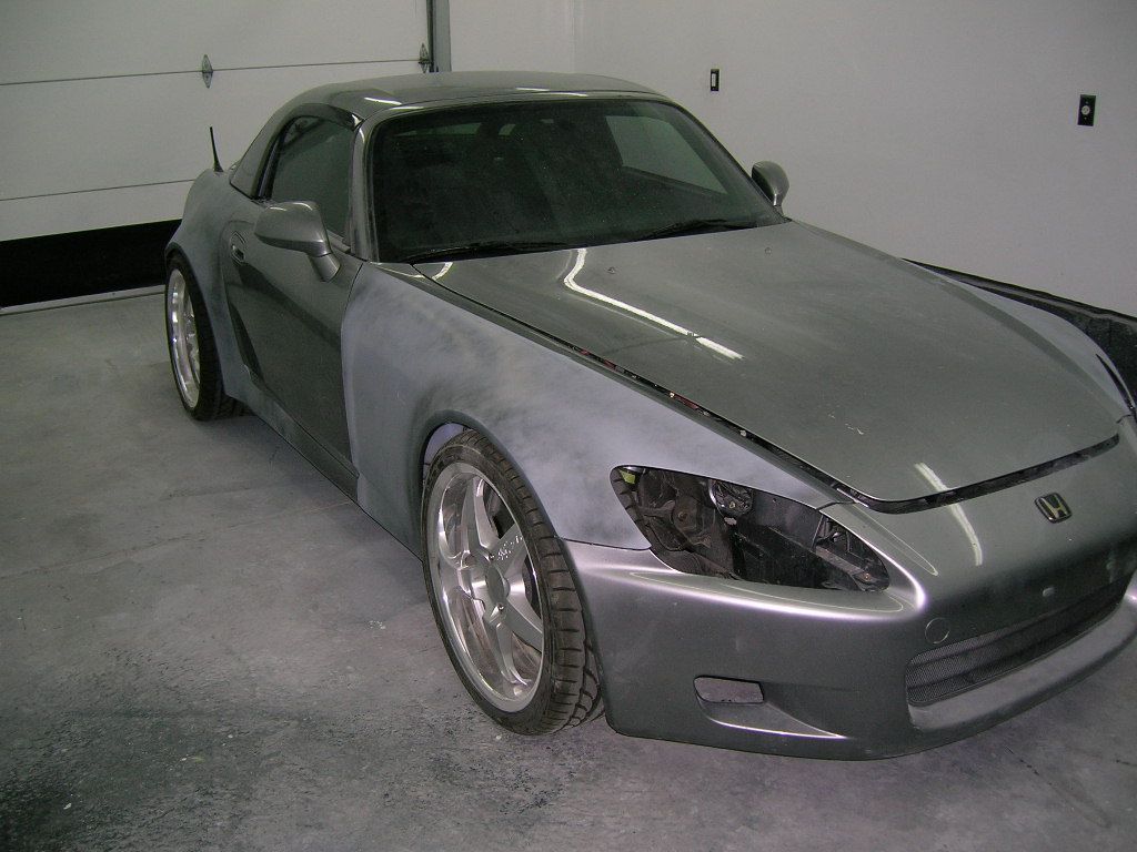

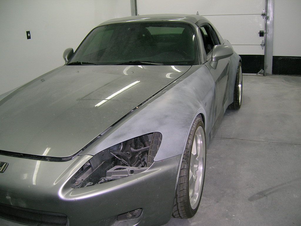

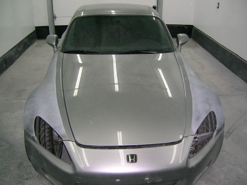

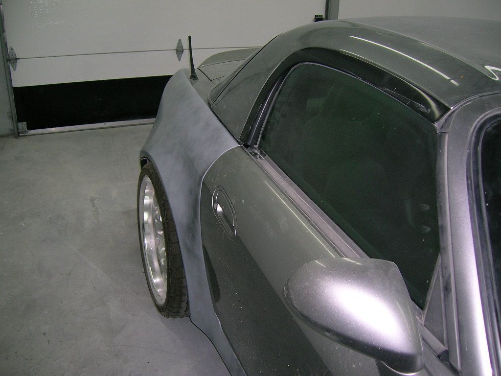

Here's a few "before" shots on Sean's widebody project. Me likey so far!
Sean - fill us in on specs (tires/rims you are running) and where you got this done. Looking forward to seeing the painted, final version!

Lets see, it was so long ago I started this project, I am having trouble remembering the specs on the wheels, but I had them made by 5Zigen to my own offset specifications.
Wheels- I think the rear are 19x10 at 15mm, and the front 19x8.5 at 30mm, but I will have to check that to be sure.
Tires- I think they are 285/35-19 rear, and 245/40-19 front. Again, I will have to check that, as I am going from memory.
Ominous Rod & Custom did all the metal work (with lots of my help), and Sonny Bonomo of Bonomo Paint Works is doing the finish and paint.
As some of you might remember, I removed my soft top to make room for the stereo system, so I am only open top or hard top, no soft top.
Once I get it painted, I will begin the work on finishing the stereo and possibly some new interior stuff as well.
It should be painted and ready for a ride in less than a week, yeah!!!!
Mendii, thanks for posting the pics for me, and sorry to hear you will be without your S for a whole year....I know how it feels.
