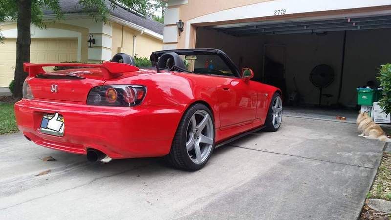

You can click the link in my sig for pics of my setup if you want. 245/35, 285/30 on stock body with just a fender roll. 285/30 has a slight stretch on a 11" wheel, 295/30 would be nicely square. S2000junky is running 255/35, 295/30 on stock body. If going with custom spec wheels, no aftermarket fenders are necessary unless you want the "look" and/or run wider tires than 255/295.
